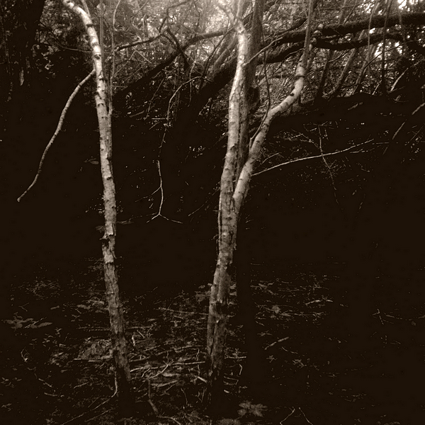

Yes.
And I've used it as well by factoring it in when making my prints.
I relied on it quite heavily in the prints I have made of this photo made using a Brownie Hawkeye:
(this is actually from a scan, adjusted to resemble the toned print)
