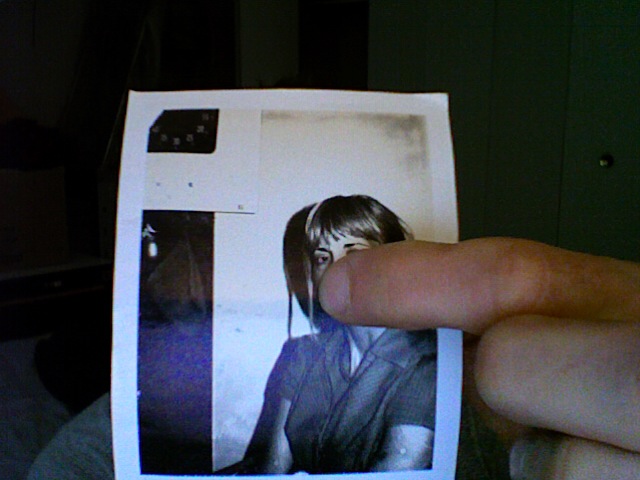

here's the one I did last night...curl from drying...
this was way underexposed by more than one stop..very dark...very unpleasing, but still an image..this is after bleaching (no scanner here--it's at mom and dads)...I had to cover the face of the person...i don't post images of people usually...
NOTE--there is STILL ENOUGH DMAX to give black blacks where the blacks should be---this seems to nicely INCREASE CONTRAST...give you nice WEEGEE looking polaroids....NICE...so now you can PUSH the polaroids!!!!!! AND get NICE PUSH results!!!!!....VERy easy to do...
