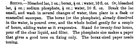

From The Photographic Annual, 1908 about sizing paper for salt printing:
I'm not sure what "bleached lac" is... could it be shellac? Anyone have a clue?
NedL
NedL
Aug 23, 2012
3,400
Sonoma County, California
Yep, and now that I'm googling the right thing, I had no idea! I remember shellac as a smelly varnish that we applied to wood. Now I see it is edible and comes from a tree in india! Learn something new every day! Even makes sense that it might be good for sizing. The site you found is pretty interesting: they claim their shellac is better because it's made from "highest quality indian seedlacs" and not seedlacs from other sources! Now I know which one to try to get!

Even the bleached shellac, depending on the concentration,has a yellow tint. I am using it for varnishing glass negatives.
Ammonia, sodium hydroxide and other strong bases will dissolve it too.
Shellac was also used in construction, as an additive in making water proof cement in aqueducts. :wink:

It's also used in stain-hiding paints, and it's useful in wood finishing if you need a barrier layer between two incompatible finishes (which is why it works in stain-hiding paints and primers).
The shellac flakes are usually dissolved in alcohol, it doesn't "cure" with a chemical change as with many resin based finishes. It is simply what is left behind when the carrier solvent evaporates. And, as noted, it's not poisonous (once the solvent is gone), so it can be used on surfaces kids might chew, like cribs or cradles or surfaces subject to food contact.
Very handy stuff.

the recipe says "Sodium phosphate" but all I have to go on is what I can find on wikipedia where it tells me there are about a zillion forms of it.
Wonder which was most likely to have been used in 1908?
