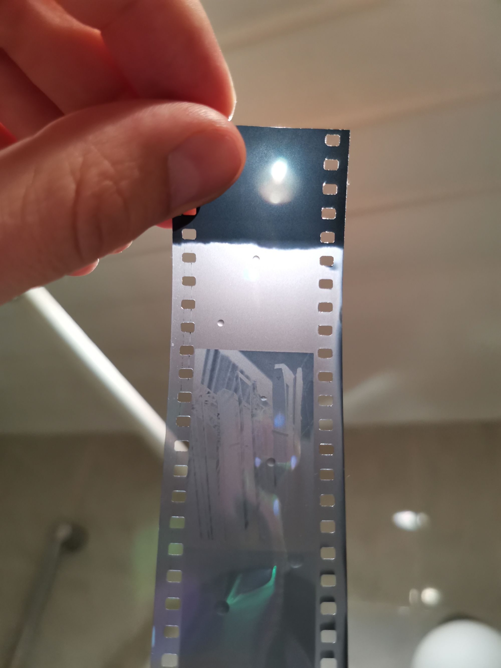

I bought some chemistry and mixed D76 and simple acid fixer by myself. And then I developed a short test roll from a Fomapan 400 bulk roll (never tried this one before). The film came out completely blank except for the film leader. Before development I checked the chemistry by cutting the piece of film and developing it under the light, it went black in about 4-5 min in stock solution. Then I tested the fixer, a cut of film went blank in about 40-50 sec. So I developed that roll at 20 C (8 min in stock solution and 3 min in the fixer with a short tap water stop-bath).
I checked the camera shutter as well, there is no problem with it. So what can be wrong with it?

I can't tell - is there any edge printing on the negatives?
There don't appear to be any edge markings on your film, so that rules out a camera issue. This is what you would see if you accidentally used fixer before the developer.
Are you sure the fixer formula you used is reliable?
I'd try developing a clip of unexposed film in the tank (don't expose to light) and follow through with the rest of the steps as normal. If your chems are good and you still see no edge markings, it may be a problem with your film.
Looks like you accidently switched the fix for the developer. The film did not develop, period. We know due to the lack of edge marking (frame numbers), and the film is well fixed.
I assume the leader was also blank....
Whoops -- missed that the leader is black-- so must be a film w/o frame numbers...odd.
What I see here, then, is film not sufficient connected to the take-up reel at the start of the roll and it did not advance in the camera -- all your images could be in that one dark exposed frame after the leader. Usually one figures this out by somehow being able to still use the camera past the normal amount of frames (12, 24, 36).
Also with most 35mm cameras if the lever used to rewind the film does not rotate as you advance the film, the film leader did not get connected to the take-up reel.
Looks like you accidently switched the fix for the developer. The film did not develop, period. We know due to the lack of edge marking (frame numbers), and the film is well fixed..
But in this case the film leader should've been blank as well, right?
Yep, if you poured the fixer first, you'd have blank leader, no edge print, as well as no images.
If the leader is black, edge print or no, it's been developed -- so the film didn't advance in the camera. That's either a loading error, or a camera failure.
This is confirmed by the partial frame visible between clear sprockets just after the leader fogging -- that's every image you shot on the roll, all in one compact 24x36 mm space. It's solid black because it's overexposed by a factor of about 30.
With almost all 35mm cameras, you can see the rewind knob or crank revolve when you advance the film. If that's no happening, you may have a loading problem (film not correctly caught on the takeup spool) or you've got one of the rare cameras that declutch the rewind knob/crank until you actually push the rewind release. Of course, many cameras with electric film advance also use electric rewind, and don't have a crank -- but many/most of those are "drop-in" loading; as long as the film lies across the takeup spool, they'll automatically catch it. The last couple generations of point & shoot cameras did this.
Yes, it sounds the most reasonable version, because the camera was an old Soviet Zorki 1 (copy of Leica II), which worked perfectly, but loading the film can be a pain in the ass. The only thing that makes me wonder is that I cut about 1 m of the roll (about 20-22 pictures) and I shot exactly 20-22 pictures until I felt I couldn't advance the shutter anymore.

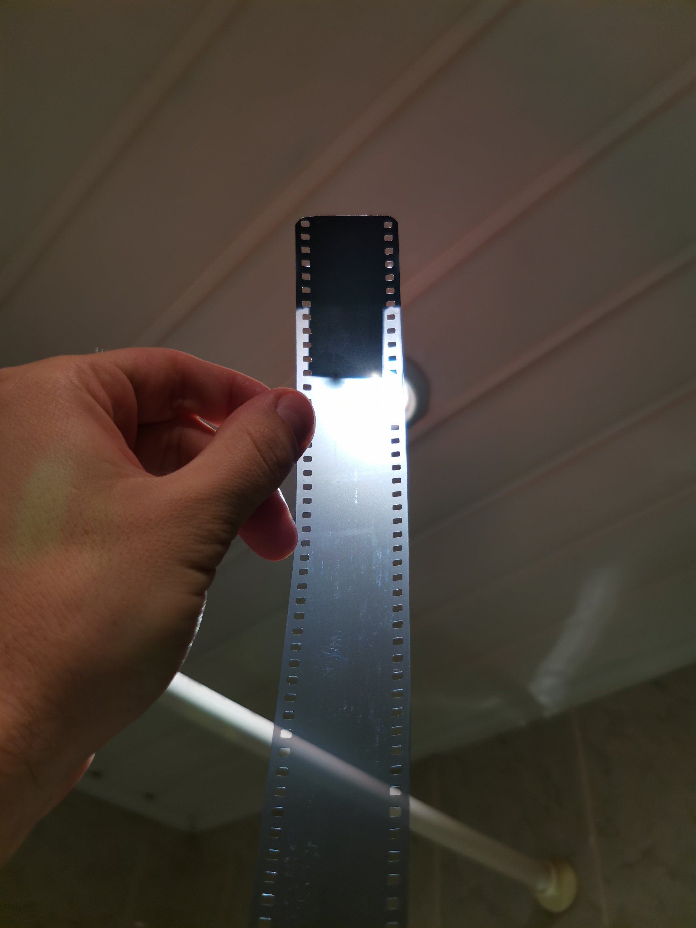

I've developed another piece of film, and at least I've got some images on it, which proves that it probably was the loading error. And yes, it doesn't have any edge markings.

Behind the black leader there is something that looks like an oblique positioned exposed frame.
To me it looks like a user error at camera stage:
My idea thus is:
-) the film was not positioned correctly at loading, thus the oblique frame
-) after exposure of first frame the perforations were torn and the film not transported any further
-) the OP did not realize this
-) at processing he threw away the part of the leader with the torn sprockets holes
EDIT:
-) or the holes did not even tear, but the leader just slipped
Bottom-loading cameras are good to induce such error.
Thank you guys, that was a loading mistake. I developed another roll of film in the same chechimals and it came out pretty well. I'm glad I didn't mess up the formulas at least.
