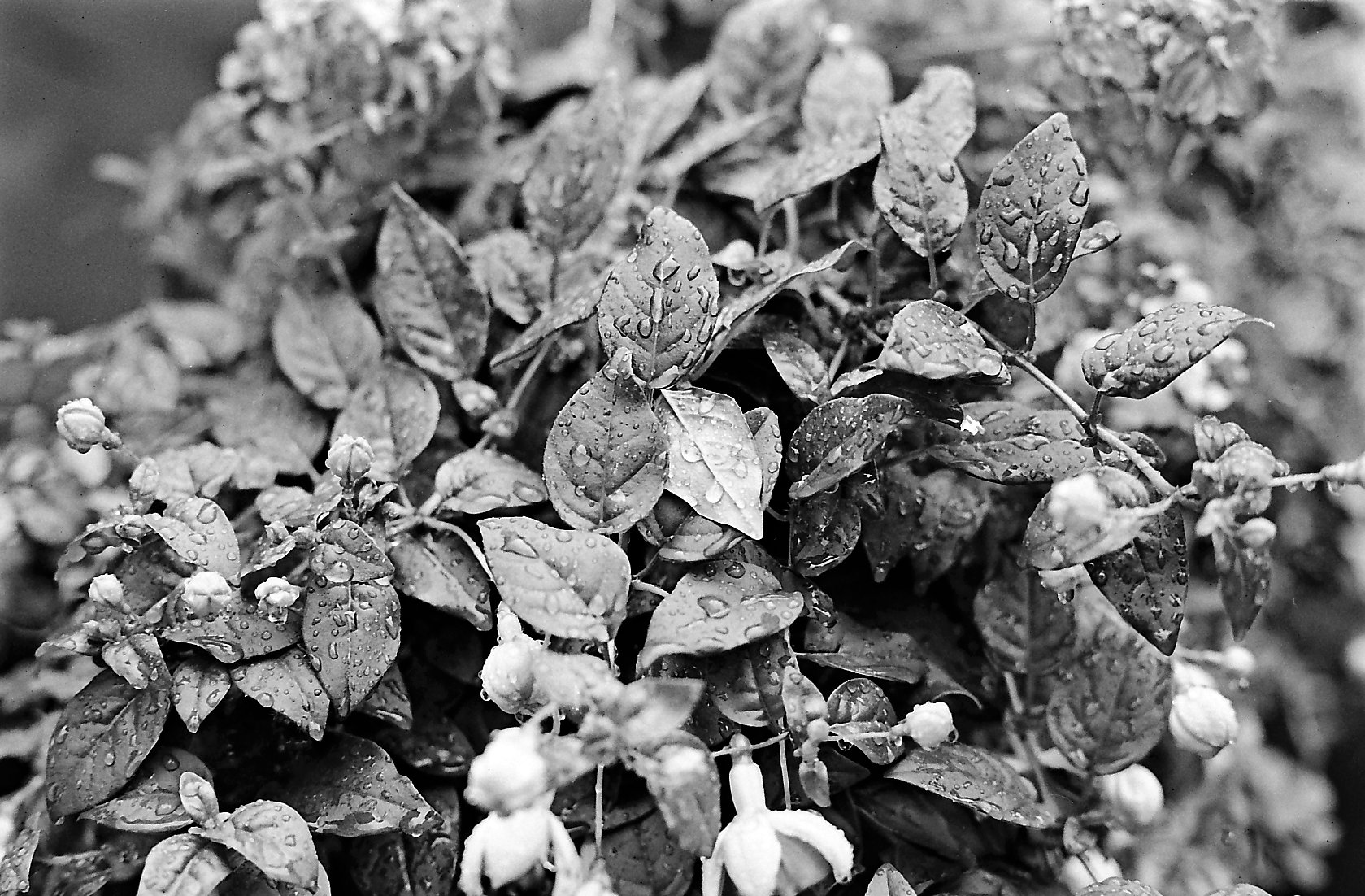

My self with Pyrocat HD or HDC I use separately marked syringes and mixing containers that are only used for this process. My self I have found I only mix a small batch 200 ml of A & B concentrates after I mixed about 500 ml and had it go south on me after about 6 mnths. I was also using Propylene Glycol which I though would last. I also have a friend who uses distilled water and had the same problems. When it works it does amazingly good negatives. Now I only use film that can be developed in Pyrocat according to DD developing chart.\
Photo was UN54 film developed 1-1-200 Pyrocat HDC

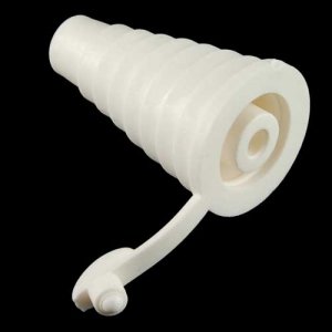

Looks like you might find these things useful for drawing up your Pyrocat HD parts.
You can find them at the local drug store, they are called oral syringe adapters.
You place them on the end of your syringe then insert in to the bottle and invert the bottle to draw the fluid.
As others have said, use separate syringes and adapters for A and B, mark them A and B so you don't mix them up.

The adapter does look useful.

Dances - FUNGUS is that shot ever sweet. The clarity is wonderful.
My syringes came with these.
