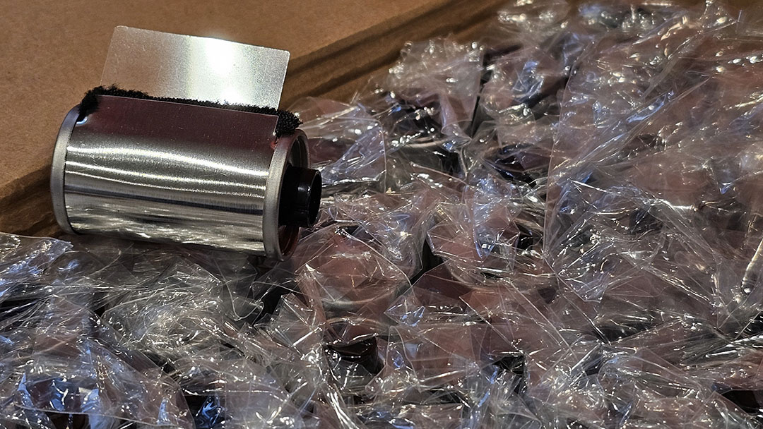

No one seems to make the old metal refillable 35mm cartridges I grew up using, but I did find a box of these ones from Shenzen.
The Chinese label just reads: "Blank Cartridge" and instead of pop-off ends so you can tape the film to the center spindle, there are these plastic flaps sticking out.
Has anyone used these, ? Just tape the film to the plastic and cross your fingers? Doesn't seem re-usable to me....

One may as well re-use commercial cassettes then and tape the bulk film to the end of film sticking out.
Many have done that for years (myself included) without problems.
You can usually get cassettes for free from your lab and I would put more trust in an Ilford/Fuji/Kodak cassette than something from a random Chinese company trying to make a quick buck.

That felt looks like a hazard

Those look nice, but I agree with @Ivo Stunga that the felt doesn't look nearly as good as on the American, European and Japanese cassettes.
Why not? When done, pull out the film, cut off and process; then tape another length of film onto the trailer.

I'm also not a big fan of the gap between the cap and the gate, stuffed with said poor felt... Tolerances seem to be off
AND the gate metal thingy seems to have sharp edges :D

the ARISTA Pan 100 film comes in a simalr cassette. end caps so well staked they don't come off and the end of the film taped to a clear leader at the center of the spool. These require the use of a leder retriver to get the film leader back out, and the film to be pulled out of the light trap in the dark to load the Tank.
they seem to be available from refix Lab in China https://reflxlab.com/en-ca/products/50pcs-metal-film-cassettes-with-dx-code-or-not-free-shipping
yes those are the ones in the pic
I recall when I saw them I was excited, But when I wrote the seller, they sated that the end caps were not removable, and the so the only way to re-use them is to remove the film through the light trap and use tape to attach the new film to the stub attched to the spool.
