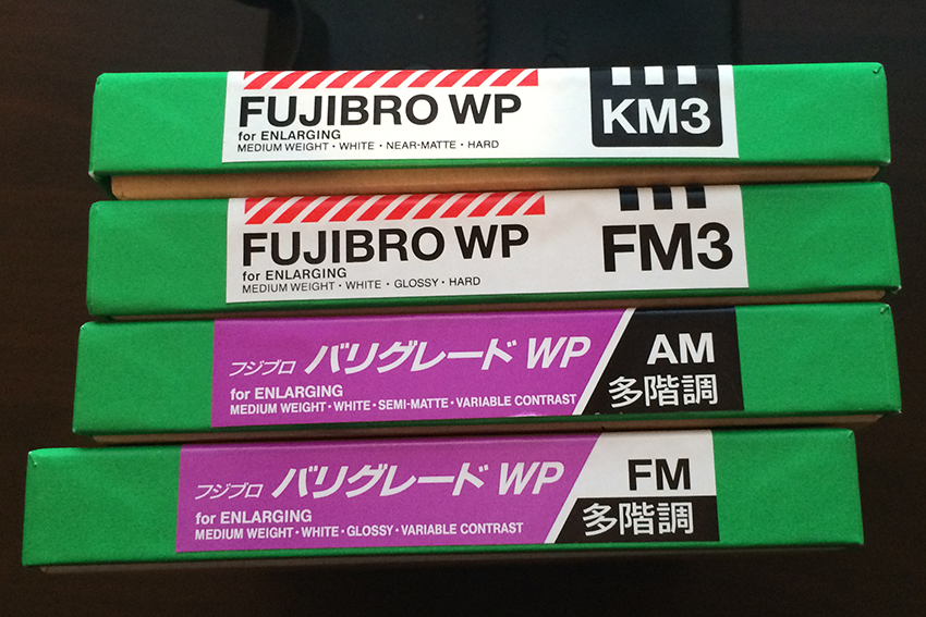

Two points. First, "semi-mattte" is Fuji's term for the surface Ilford refers to as "pearl." That finish is not at all inherently unable to achieve deep blacks. See the maximum density Multigrade Warmtone RC pearl reaches, for example.
Second, neither Japan Exposures listings nor any Fujifilm pages I'm able to dig up using translation programs seem to list a VC version of Fujibro. The only type I can find is fixed contrast, available in grades 2, 3 and 4. Is this VC Fujibro commonly available in Japan? If so, I'll ask Japan Exposures to get me some!
mooseontheloose
Sep 20, 2007
4,110
Kyoto, Japan
Sal, there are two versions of Fujibro: the fixed contrast with the code WP KM (near-matte) or WP FM (glossy), followed by the grade - 2,3,4; and the variable contrast with the codes WP AM (semi-matte) or WP FM (glossy). The fixed grades have a white and black label, the VC paper label is purple. There is no "V" sound in Japanese, as such, translation programs will turn "varigrade" in "bali great or bali grade".
Thanks Rachelle. In your estimation, is the WP AM equivalent in surface texture/sheen to Ilford's Pearl? If so, I'd really like to try some Fujibro semi-matte.
