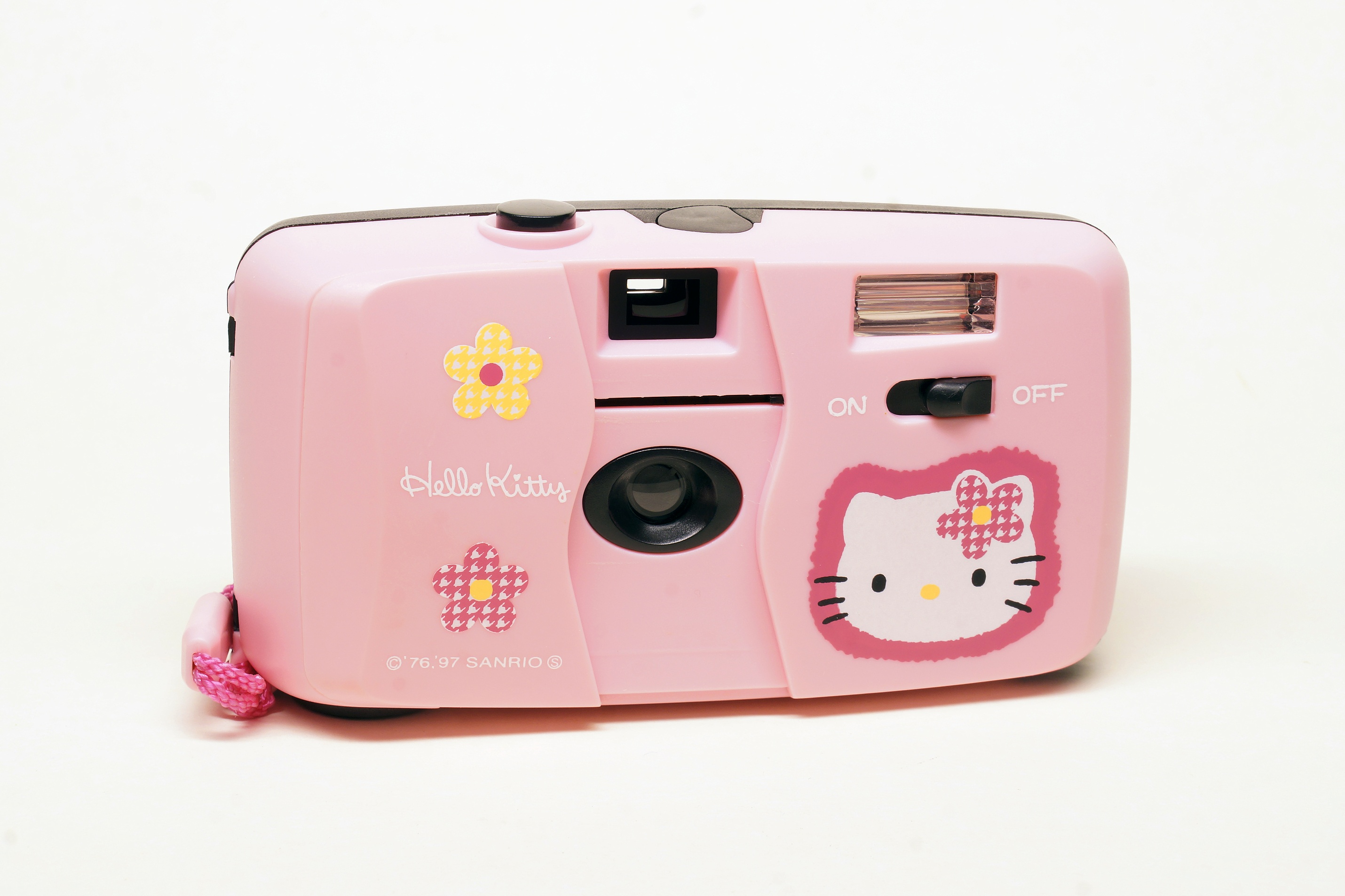

I achieved good results the first time I used it - I was so pleased! Here is the first image I shot with it and the camera I used to take it with, my Hello Kitty camera. The picture shows my wine refrigerator out in the pantry (an appropriate subject, I thought.) As you might guess, I have a WHOLE lot of fun with my photography!
