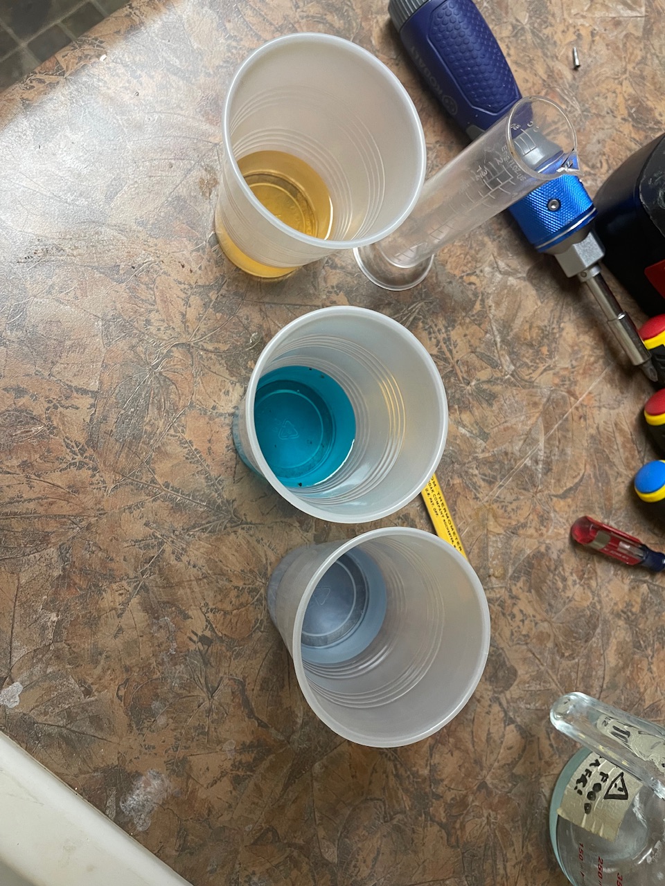

For those familiar with black and white reversal, how should I test the bleach to make sure it’s still good? I tried just doing a clip test with some film that has been exposed a while in the light, but the bleach did not clear the film and the remaining silver turned around as black as it started.
You should take a film strip, expose to light, develop, bleach and a brief clearing bath.
The strip should come out perfectly clear. if it doesn't the bleach and the developer are shot.
Can you post a pic of your bleach?
I use a 2 step bleach, CuSO4+NaCl, and the Ammonia. Here’s after the test (from top to bottom: dev, bleach A, bleach B)
And the film after getting developed and bleached:
I think maybe I just need to mix up more bleach.
