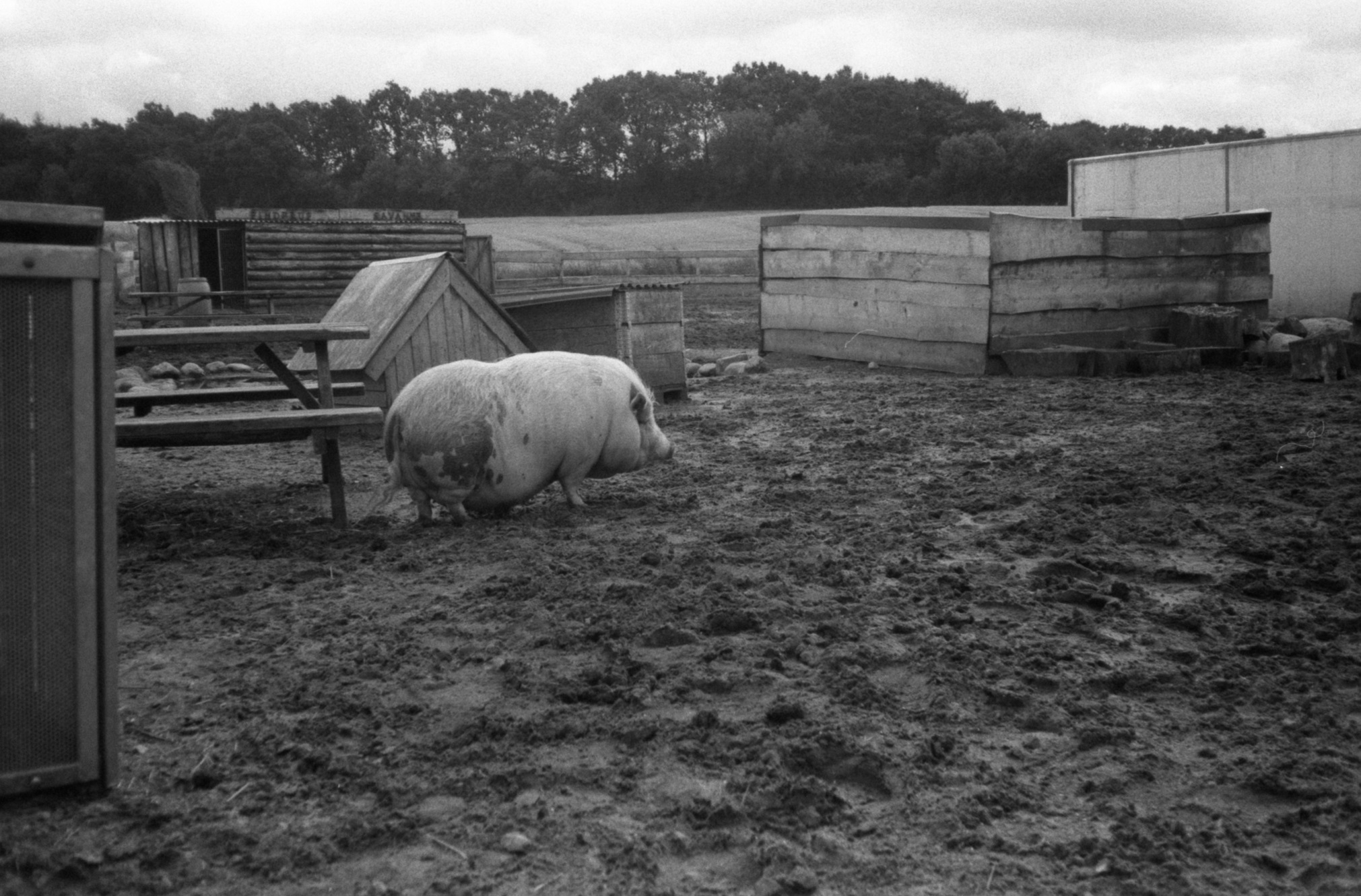

I think i have solved my problem.. i have put together a device to take care of agitation.
This picture is developed in 1:50 Rodinal, 30 sec agitation followed by 10 sec every min for the duration of 11 min. -fomapan 400 at box speed.
The pig is obvious a cutie but besides that -how would you rate this development?

The last photo looks great. Perhaps the dark spots were air bubbles on film surface. Best practice is to bump the tank on a hard surface after filling to dislodge such bubbles. I forgot to do this once in 35 years just the other day, and lo and behold, had a similar problem.
gone
Jun 14, 2009
5,504
gone
It's hard to say too much about your piggie pic (he/she is sure well fed) because it's an online scan, and that makes it very difficult to know what the actual neg looks like.
The development looks clean though, so it looks like you fixed your problem. You might consider using normal tank development and agitation though, because your shot above looks nothing like what I get from Fomapan 400 w/ F76+ and developers like it.
My experiment w/ Rodinal at 1:50 and developed in a traditional developing tank didn't look very good, so your stand development didn't exhibit the grain issue I was warned would be there (but like you, I wanted to try it, just to see for myself).

Thanks!
I did bump the tank but it could still be airbubbles.. -the new agitation pattern seemes to fix the problem thou.
if i want i bit more black in my pictures but not more grain -should i amp up the initially agitation from 30 sec to 60 sec? -or do something else?
it could also be that it's ok as is, the picture was taken a day with an overcast sky so dull contrast may be a result of motive and lightning.
i am too new in this to tell.. ;-)
