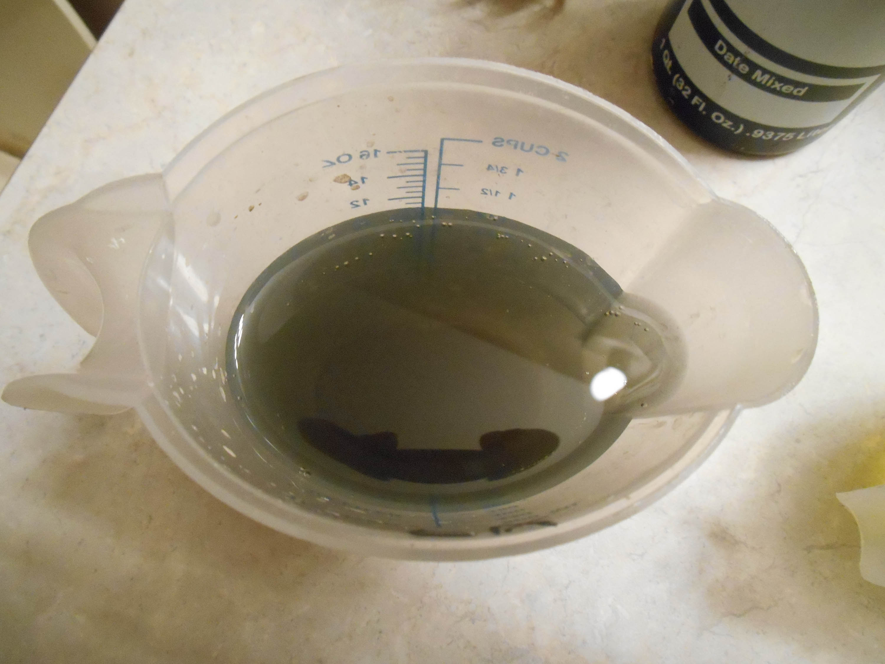

I developed a roll of Fomapan 400 (Arista EDU Ultra) and after that roll, I noticed my fixer was quite black, with black flakes sedimenting on the bottom of my cup. I poured it all out and you could see the black flakes on the sink bottom. What is this? Does this mean I should have pre-rinsed my film?

Most likely it is silver that is plating out, and your fixer needs to be replaced.

Ok. Its good I dumped it then. And I just bought a fresh new bottle of fixer on Saturday too. What is plating out?
elemental silver; this is pure silver. Congrats! You are into precious metals now. You could investigate silver recovery units and sell the stuff, but don't give up your day job quite yet!

What is this?
Keeping around working stock fixer for too long, allowing to oxidize, as well as overusing it far beyond its stated capacity.
It means that the silver that's dissolved in the fixer in the form of soluble silfer-thiosulfate complexes starts to precipitate in the form of metallic silver. It often deposits as a thin film of silver inside the container it's in if it's left to sit undisturbed - hence the term 'plating out', because the effect is similar to electroplating e.g. nickel or chrome (and the chemistry involved is in fact conceptually similar, too).
In your particular case, it's not just plating out, though. The fixer looks cloudy with yellowish tones, which suggests it's also sulfuring out. I.e. elemental sulfur is being formed that floats around in the liquid in the form of tiny particles.
All of this suggests that I mentioned above - that the fixer has become unstable due to overuse and oxidation. It's best to keep good notes on the amount of use working stock fixer has seen, and not to keep it around for too long even with mild use. When storing used fixer, it helps to keep it in a sealed container with little or no air on top of the liquid.

The upshot, however, is that you need to refix your film. And check the most recent ones, too.

If your fixer is throwing that much silver precipitate, it is likely way, way past it's useful life and you've been underfixing things for a while now.
Read up on fixers and capacities and learn how to do a clearing test. Ilford's tech sheets are extremely informative.

Its weird because even the most recent films I did look completely clear with no fog. Oh well. I'll try to mix up a fresh batch. I didnt think I did that many films in this fixer batch, though it has been sitting for quite some many months inside a capped/ sealed 1L container.

many months
Yeah, that's not a great idea, obviously.
Fixer can (seemingly) 'topple over' virtually instantly. What happens in reality is that the sulfite present to protect the thiosulfate from oxidation gradually is turned into sulfate through the influence of oxygen. At some point, the sulfite gives out and then the thiosulfate starts to degrade. At this point, the fixer (with its suilver-thiosulfate complexes and all) becomes chemically unstable and as a result, things can go south seemingly very rapidly all of a sudden. In reality, the decay is gradual, but it's a kind of metastable system, which makes it seem more instantaneous than it really is.
I had that happen with one of my paper fixers a few weeks ago (I use two trays of fixer for paper and keep them in sealed containers when not in one). One day, the fixer had suddenly turned murky - almost black-looking.
You need to reexamine those films in the midtones. Spent fixer has little difficulty fixing unexposed film but has significant difficulty in moderately exposed film. Unfixed midtones look weird when tipped at an angle to the light. They look odd in a scan, too (kinda glowy). Also, the not-fixed-out undeveloped silver may take some time to become visible.
