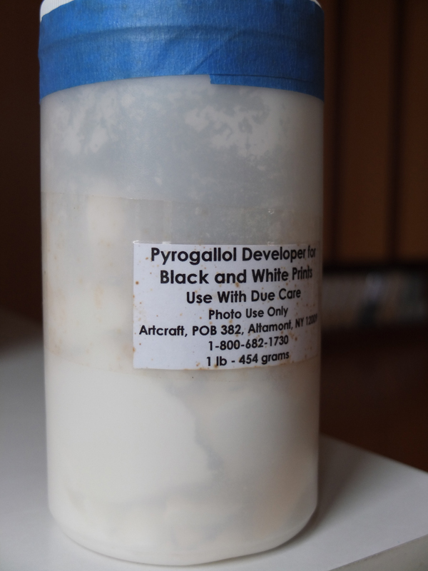

I just got the fresh supply of pyrogallol from my local dealer, and it was all dark, nearly black. It look as crystaline powder, but black. Being no chemist, I could not argue with the guy, who kept telling me it is perfectly all right and that it should work no prob. Did you pyro guys think I should trust it or rather demand the replacement?
Thanks for help.

Pyrogallol should be light grey (almost white) not black. I think you should sent it back.
I include a picture of mine which is almost two years old stock

Thanks a lot, that is what I would expect pyrogallol to be. I will ask for the replacement, then.

Definitely not good, take it back.
I still have some pyro that's well over 20 years old and it is still white or nearly so; it has been well-stored of course.

You don't say how the pyrogallol was packaged. I have had problems with some developing agents packed in plastic bottles. I have had pyrogallol keep for many years in glass bottles. Some plastics allow oxygen to diffuse into the container. I would recommend getting your money back.

Anyway, the matter has been concluded - I have received the replacement, which seems fine and proper.
