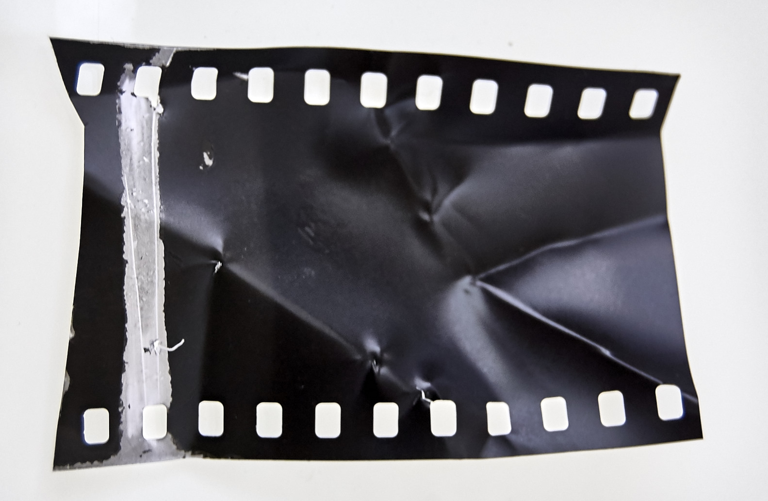

Today, for the first time, I found black stuff in my development tank after developing film. I've no clue what this could be. I'm going to filter it through a coffee filter later and dry it, maybe I can make out what it is. I've been doing the same process for over 20 years and never had something like it. That being said, there was one alteration today: the use of acid stop bath for 30s (citric acid) instead of two water exchanges.
I'm suspecting something, but I'm not sure... could the acid (or the developer) have dissolved the plastic of the Kindermann tank cap and the particles were trapped in the tank? The tanks are not the youngest, but I never had a problem and the caps look fine visually. The fixer is clear and the discarded wash water was inconspicuous too, the particles are in the tank only and i've discovered them after taking out the spools.
The film looks good on first sight. Hope it is ok and there are no spots or something.
Anyone seen a thing like this?
Oh yes: I'm using distilled water for the developer, fixer, and photoflo working solutions. Used tap water and 2 TSP citric acid for the stop (1L). I doubt its something in the water. Developer Rodinal, neutral/slighty acid fix. Ilfrod fill&dump wash. Kindermann SS 1L tank with plastic caps and SS reels. The film was Neopan 400 135. I filled/dumped the tank in daylight through the cap (except for photoflo which I did in a separate beaker)

Looks to me like bits of emulsion from fringing at the edges, due to age, damage or too-long wet time. If there's none on the film, then it shouldn't be a problem. Check your film edges/sprocket holes to see if there are tiny bits of emulsion missing.

Way to go Doremus, that's it!
I checked the emulsion on the negs/sprocket holes which is perfectly fine. But the leader is not. I've totally forgot about it and didn't even look at it before discarding it. But that's it. Looks like a small band of emulsion was scraped off the leader.
Wet times are not excessive, in total 30min max (excluding drying time). It looks like mechanical abrasion. Maybe I wasn't careful enough when spooling the film.
Mystery solved. Thank you very much :smile:
Andi
PS: That's not the usual leader look, I crumpled it up before discarding.
