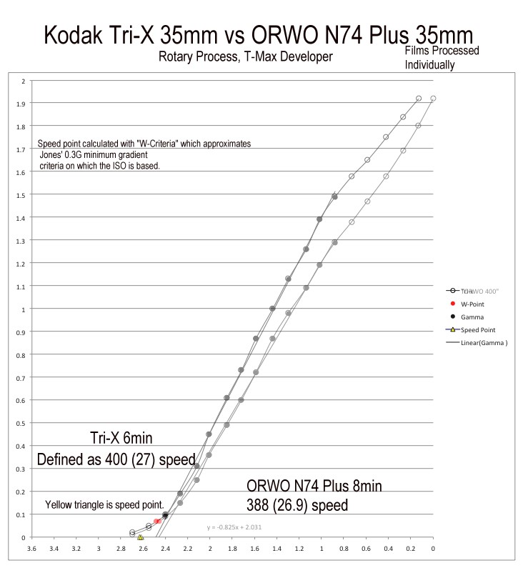

I compared to Tri-x. Probably another 30 seconds of development for the OWRO and the curves would be pretty similar.
