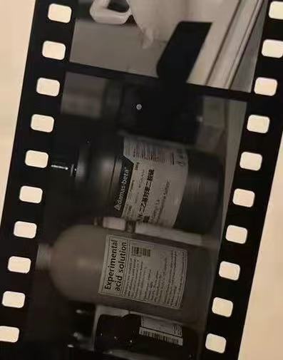

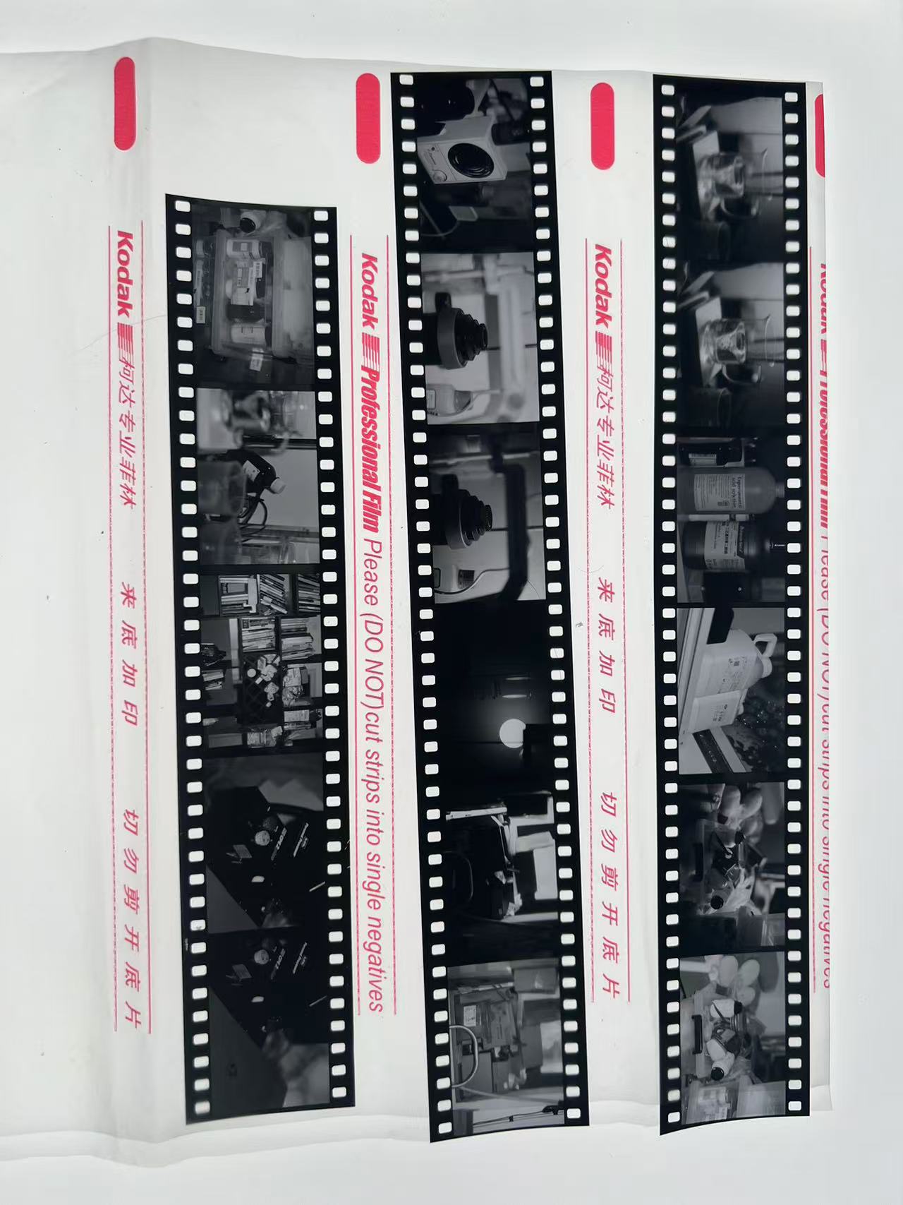

Neilnewby
fert
Oct 2, 2023
36
china
name cas weights
60 per cent sulphuric acid
30ml
High cerium sulfate 13590-82-4 30g
ferrous sulfate 10028-22-5 20g
A total of 200 ml of concentrate is prepared, which can be diluted to 1 litre of working solution. The time is 3 to 5 minutes.
In the bleaching directly after the use of film stopping solution or sulfuric acid solution to clean, cleaning after the start of water washing, more water washing several times, to ensure that the cleaning is clean. Later you can start the second exposure and the second development.
