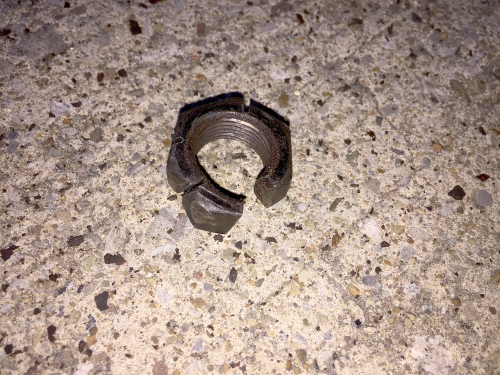

At least that is a common enlarging lens and should be easy to replace. I have two of them.
I just replaced the tie-rod ends on my car. The lock nut was tight...very tight. Even after heating with a torch, so I split it with a cutting wheel. You might consider that option.
