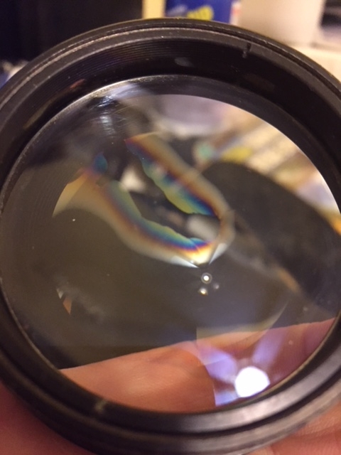

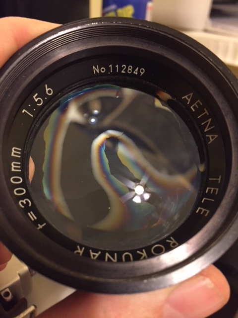

I have an admittedly very cheap Atena Tele Rokunar 300mm f5.6 lens that came on a Minolta SR-1 camera which has a very strange defect in the front element.
Ever seen anything like it? I assume it is the Canada Balsam lens cement eroding between the front elements, but I see no evidence of fungus.
Just for grins, I think I might pull it apart and try to re-cement the elements with a clear UV optical adhesive.
Anyone ever tried this?

Newton "rings" due to separation. Just for giggles, put a decent shade on the thing & expose a couple frames, you'll be surprised how well it works as-is.
edit- the lens likely is cemented with epoxy, balsam usually looks yellowy & crispy when it gives up

I might do that: a before and after study!
I highly doubt it will materially effect the "performance" of this lens...

Test it before you use it for anything that matters. I have a beautiful, except for very strong Newton's rings, wide angle converter (25 mm to 15 mm) for a 25/1.4 Cine Ektar. Footage shot with it (for test, naturally) captured the rings, was garbage.
Probably not Canada balsam, probably a synthetic cement. From the late '50s through perhaps the early '70s several European lens makers, most notably Rodenstock and Voigtlaender, used a synthetic cement that separated badly. Out of warranty, of course. I have some really horrible Apo-Skopars and a 58/5.6 Grandagon that arrived with magnificent rings of fire. The big surprise is that the Grandagon seems to have healed.

Changes of temperature/humidity can change the air space in the failed bond joint and hence the characteristics of the Newton rings. I’ve seen the phenomena before. No magic self-healing there, unfortunately.
