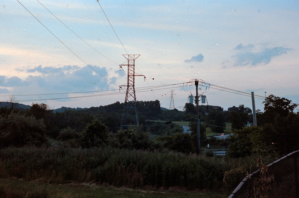

Hey all, I've encountered a strange problem with my last batch of C-41 negatives, where I'm seeing weird flecks of some semi-transparent contaminant all over the scans. When I look at the film itself, I see what looks like bits of reflective material on the emulsion side. One interesting aspect of these flecks is that they seem to be mostly limited to the 35mm rolls I processed, and only appear in small numbers on the 120 rolls I had in the same batch. This occurred on 3 different rolls, all different emulsions purchased at different time (the example photo is Portra 800), and stored in a freezer. I have a few guesses as to what this is, but I'm wondering if anyone else has encountered something similar.
Here is an example image:

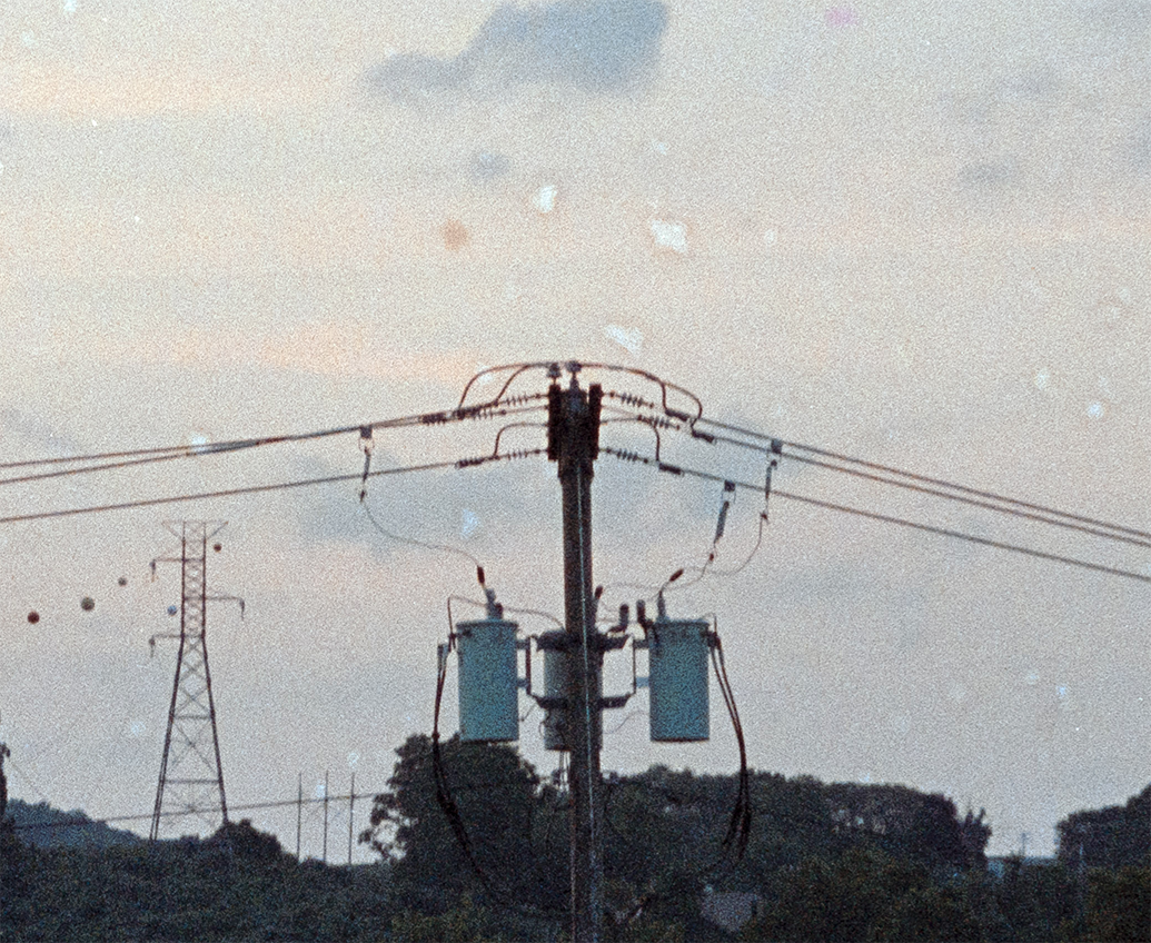

And an enlargement of some of the marks:

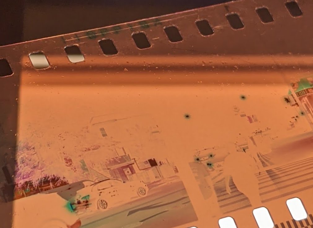

This is the best shot I was able to manage. You can't see the reflective aspect as clearly here, but you can get a sense of what the stuff looks like on the negative (this is the emulsion side):

This is the best shot I was able to manage. You can't see the reflective aspect as clearly here, but you can get a sense of what the stuff looks like on the negative:
Thank you for posting the photo of the neg strip.
From looking at your image of the neg strip, I don't think it was the changing bag, unless you can see bits falling off the inside when you open it. !
It looks to me like it's the wash or final rinse.

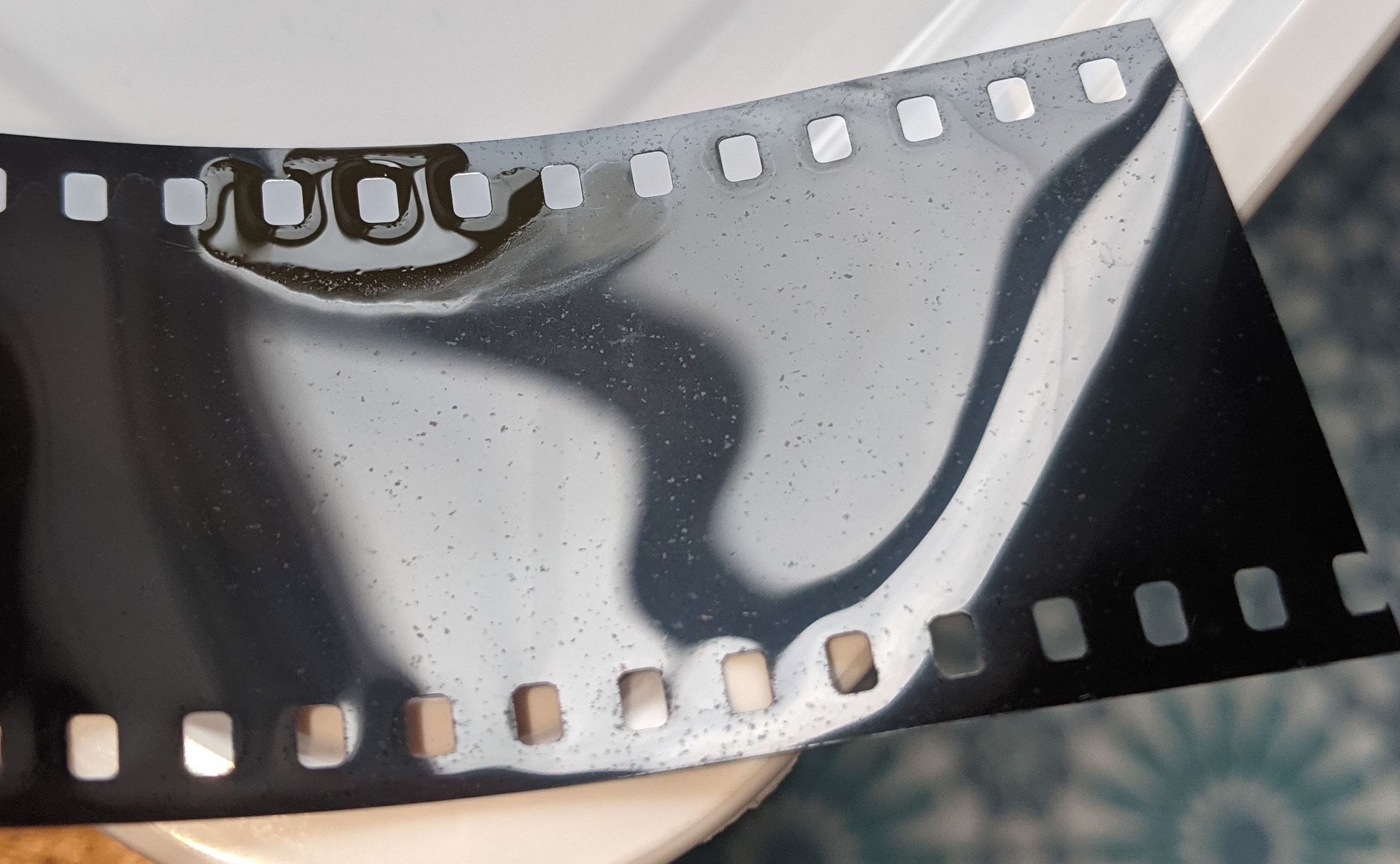

So I don't have any final rinse on hand, and I won't be able to try this until I get back into my studio, but I just attempted a test with a bit of leader that I clipped from one of the affected rolls and some photo-flo. I rubbed pretty hard but after drying I can still see the material on the emulsion. I also tried earlier with some Pec-12 and a Pec Pad and wasn't able to get any of the stuff off. This is why I was thinking it might have been incomplete fixing, because whatever this is is really hard to remove. It's also possible that it's really embedded in the emulsion.
Editing to add a photo of the film post-rinse, which gives a better view of the substance on the emulsion. It really does look to me like a coating or something that has partially come off?
Your photo shows it up very well. It sure looks embedded in the emulsion.
Could you try refixing the leader piece in your image above, then rewash and use the wetting agent and rub and see?
