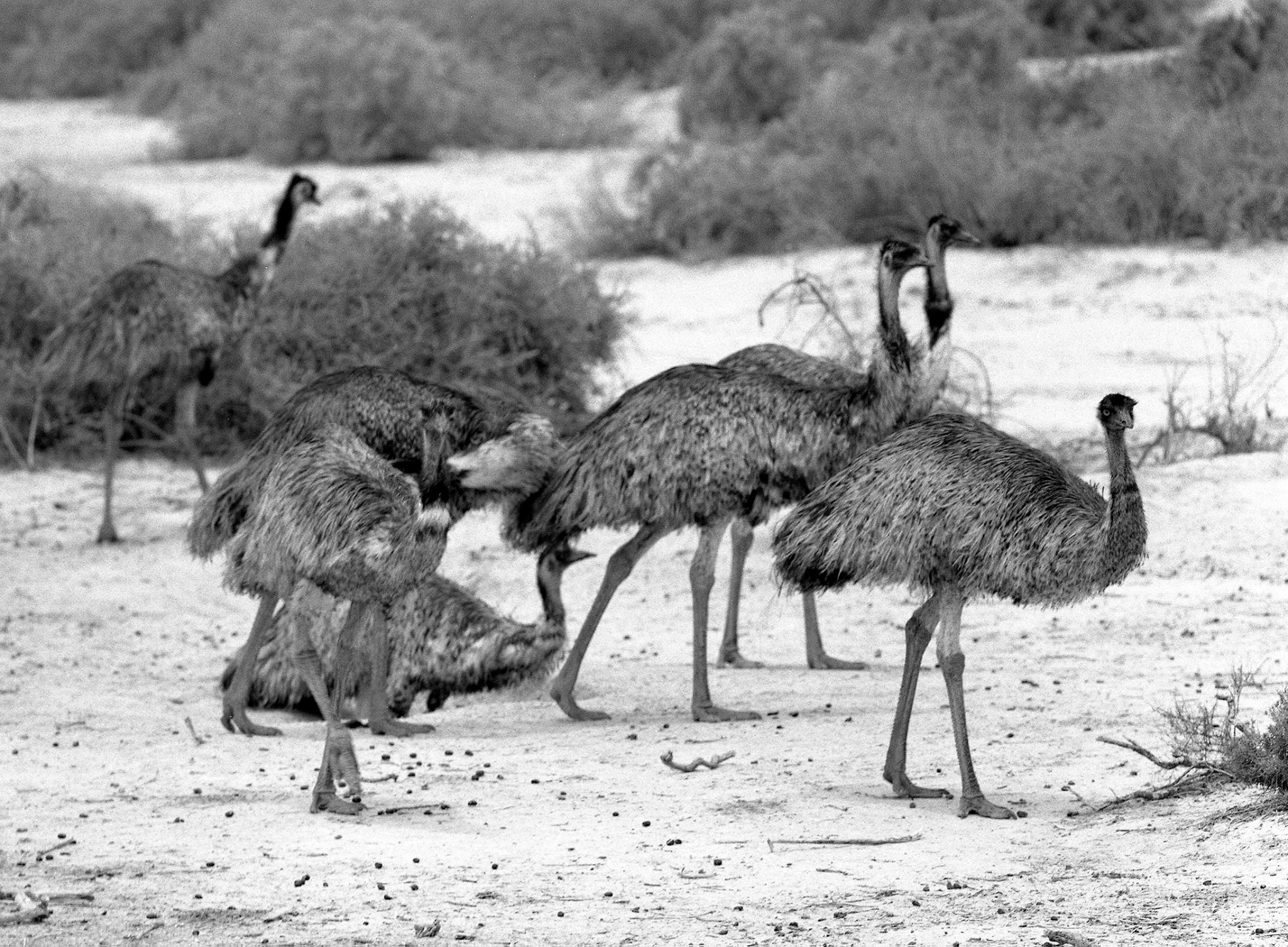

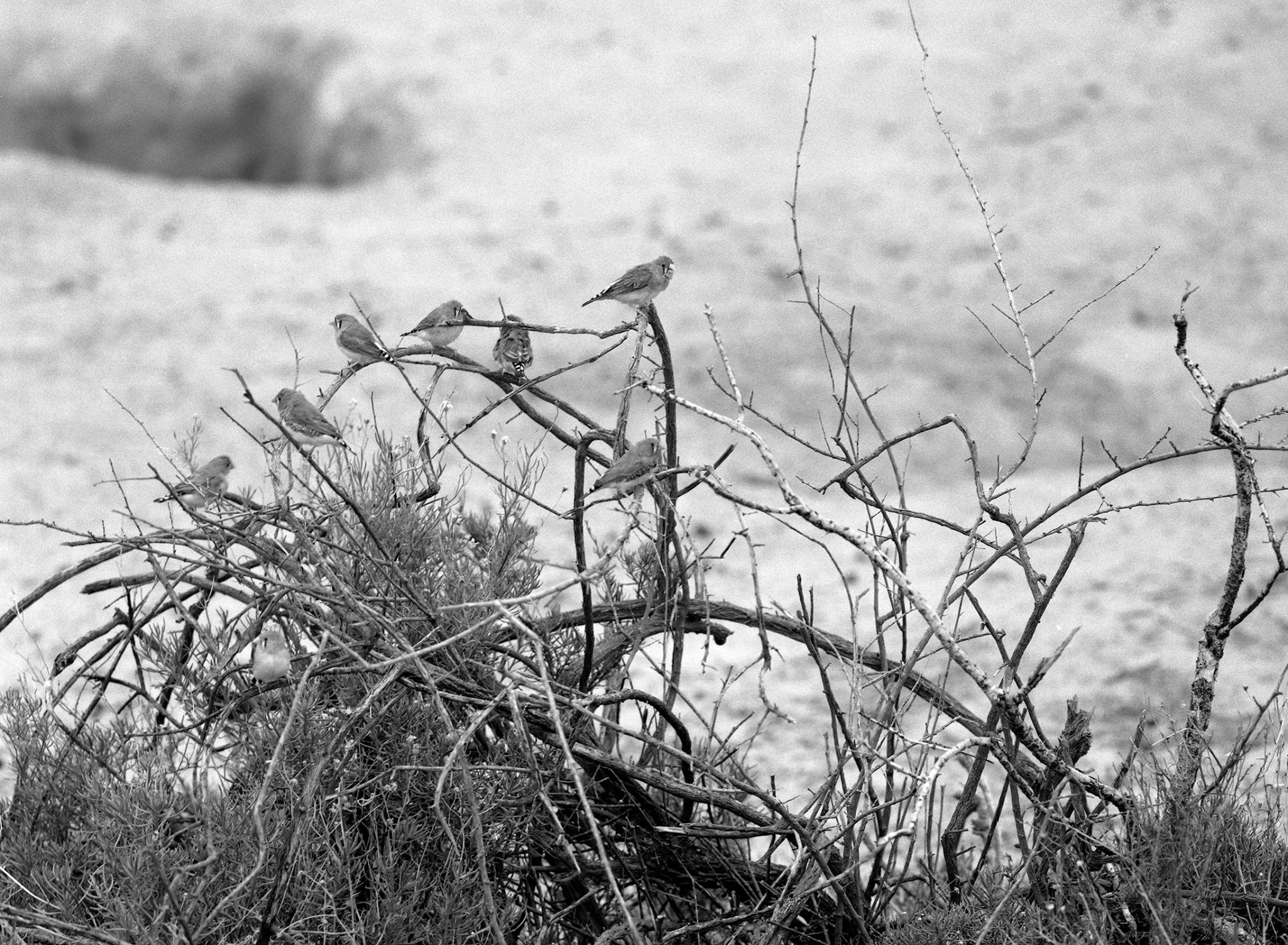

10679895_10153061619703313_1198891597560808016_o.jpg 10847577_10153061947243313_492855525620944724_o.jpg
Here's some birds I shot last week whilst wandering around the outback. Emus and Zebra Finches, both handheld with Mamiya 645 Super and 300mm lens on Fuji Acros Neopan 100
