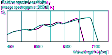

This diagram shows the transmission of a Hoya R-72 filter (taken from here)
Overlayed in black is the spectral sensitivity as taken from the Fomapan 200 datasheet.
As you can see there's a small part of the spectrum between 700-720nm where the film has some trailing sensitivity and the filter passes some light. This is most likely the exposure that you're seeing.
I also mentioned before that a proper A/B test would tell you a little bit about what the beet root juice does. You mentioned having tested with Fomapan 100 and the IR filter, but if you look at the spectral sensitivity of Fomapan 100 and compare it to 200, you'll notice that there's a very significant difference especially in this regard:
Cyan = spectral sensitivity of Fomapan 200
Magenta = the same for Fomapan 100.
Evidently, the reason why you were getting a better image with the beetroot-treated Fomapan 200 than on the untreated Fomapan 100 is because the 200 had some trailing IR sensitivity to begin with. You could only conclude that the beetroot juice at least did not entirely remove this sensitivity.
Do the same test again, but now with two sheets of Fomapan 200: one treated, one untreated with beetroot juice. Expose and process identically. Then report back and let's see what you've got.
