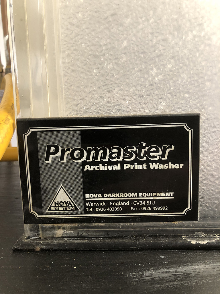

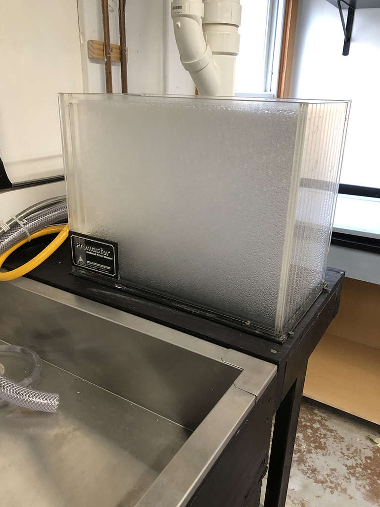

HI all,
I recently acquired a very nice Nova System Promaster Archival Print Washer. It works very well for 11"x14" prints, but since the wash chamber is about 14"X16" small prints like 5"x7", and even 8"X10" have a tendency to slip down into the narrow slots, making them difficult to pull out. Has anyone with archival washers like this or similar devised some clever workarounds to pull out smaller prints when they are done washing?

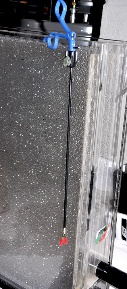

I ran into this issue when I got my Nova 20x24 about 20 years ago. I use this long grasper.
However, it seems in recent times most paper I use will float.
