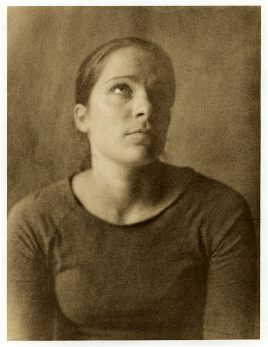

Hi,
if you're lith printing, just make sure to overexpose the print by a LOT in the enlarger for a very early snatch point. I've attached a print I made the other day. It's from a 4x5 negative, Tri-X in Pyrocat-HD developer. When I make a regular 11x14 print from this, I can't see grain at all. The lith print is different as you can see. This is from an 8x10 print and it's very grainy.
May I suggest Fotokemika Varycon for grainy results when lith printing? It is a beautiful paper in lith. I used Forte Polygrade for this print, but it's no longer made.
Basically, as long as you get your printing done right with respect to grain, it doesn't matter much how grainy your negative is - as far as lith printing is concerned.
Hope this helps.
- Thomas
