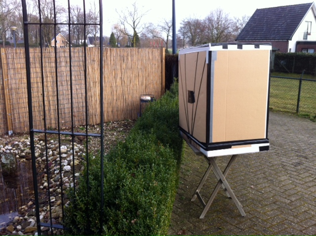

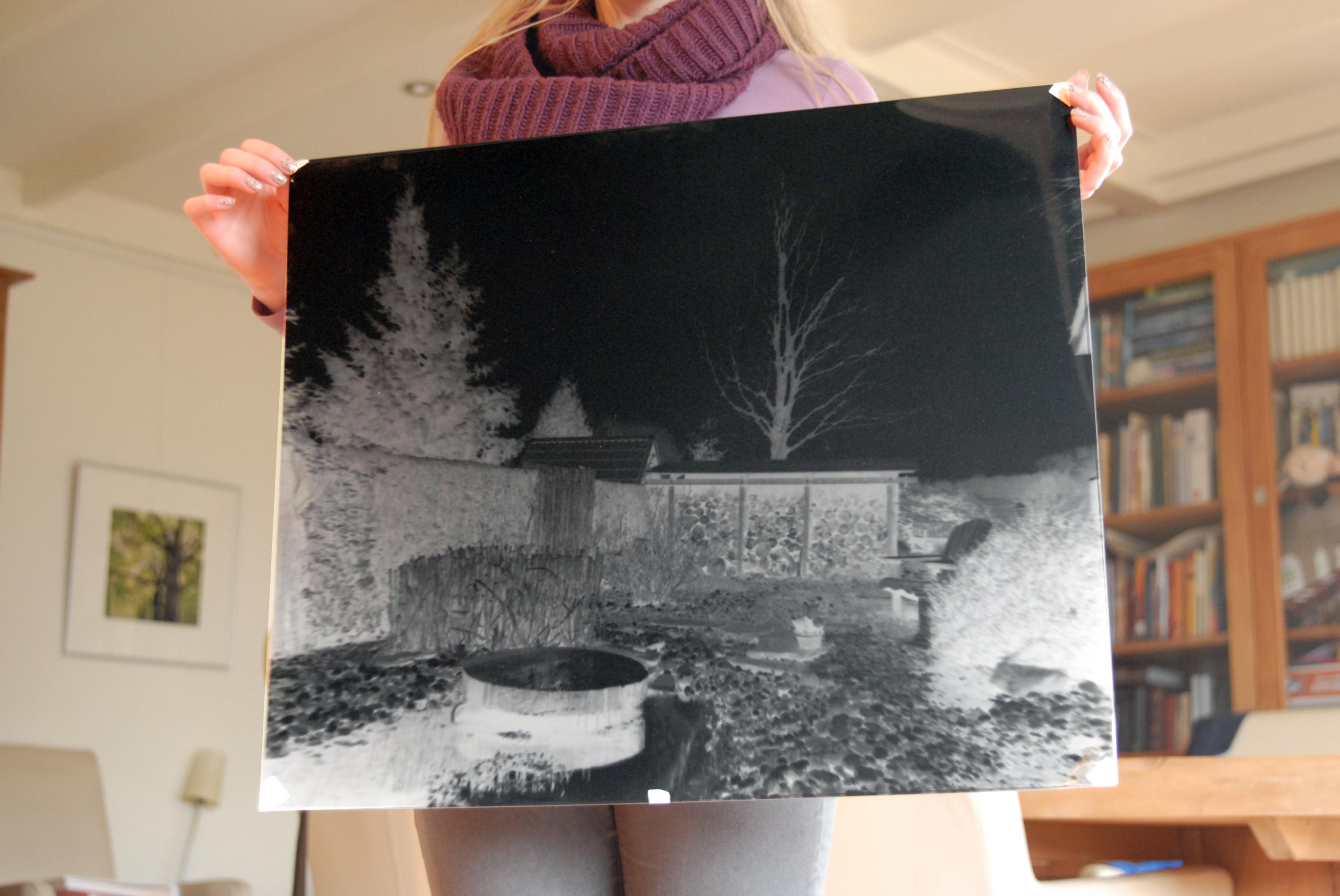

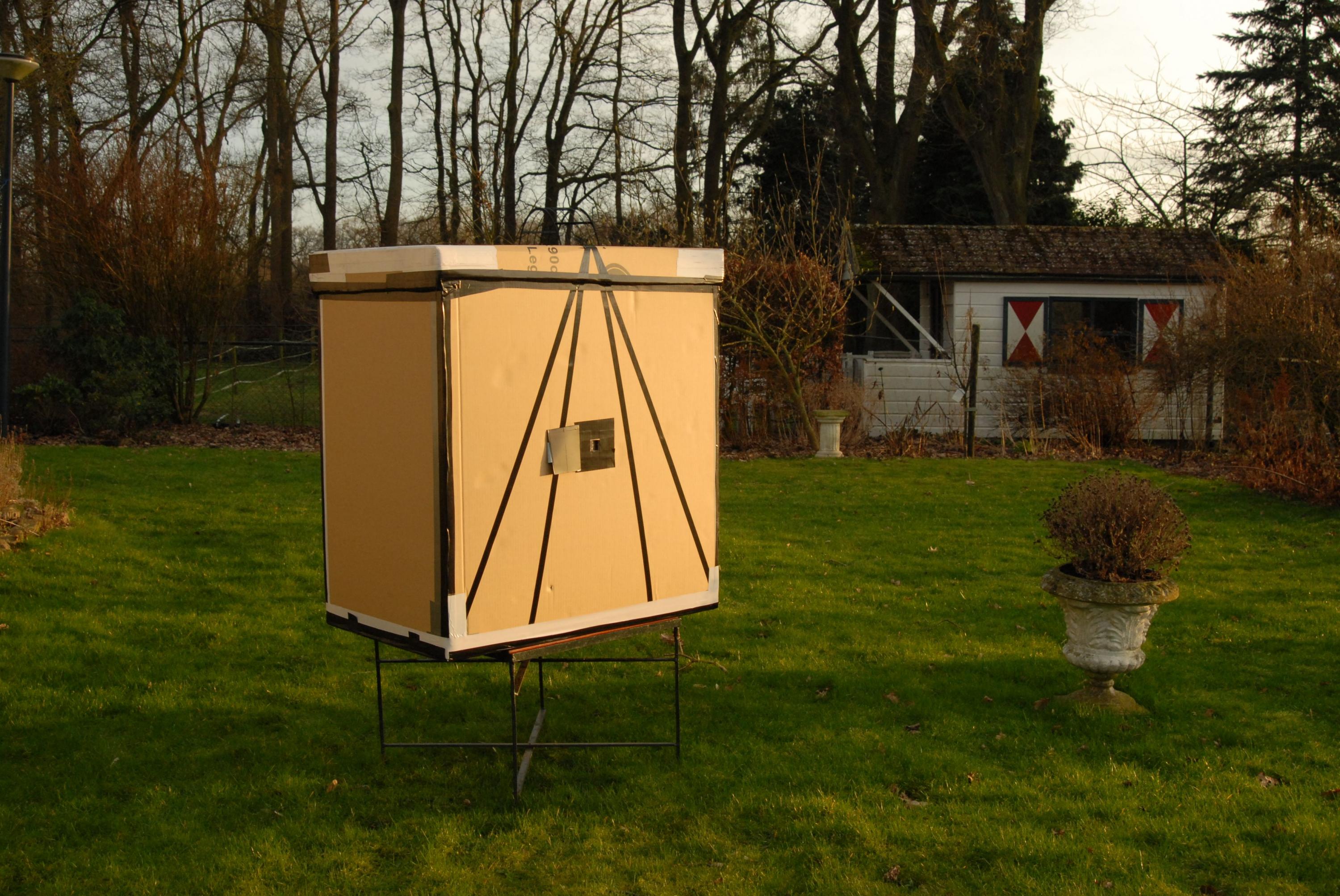

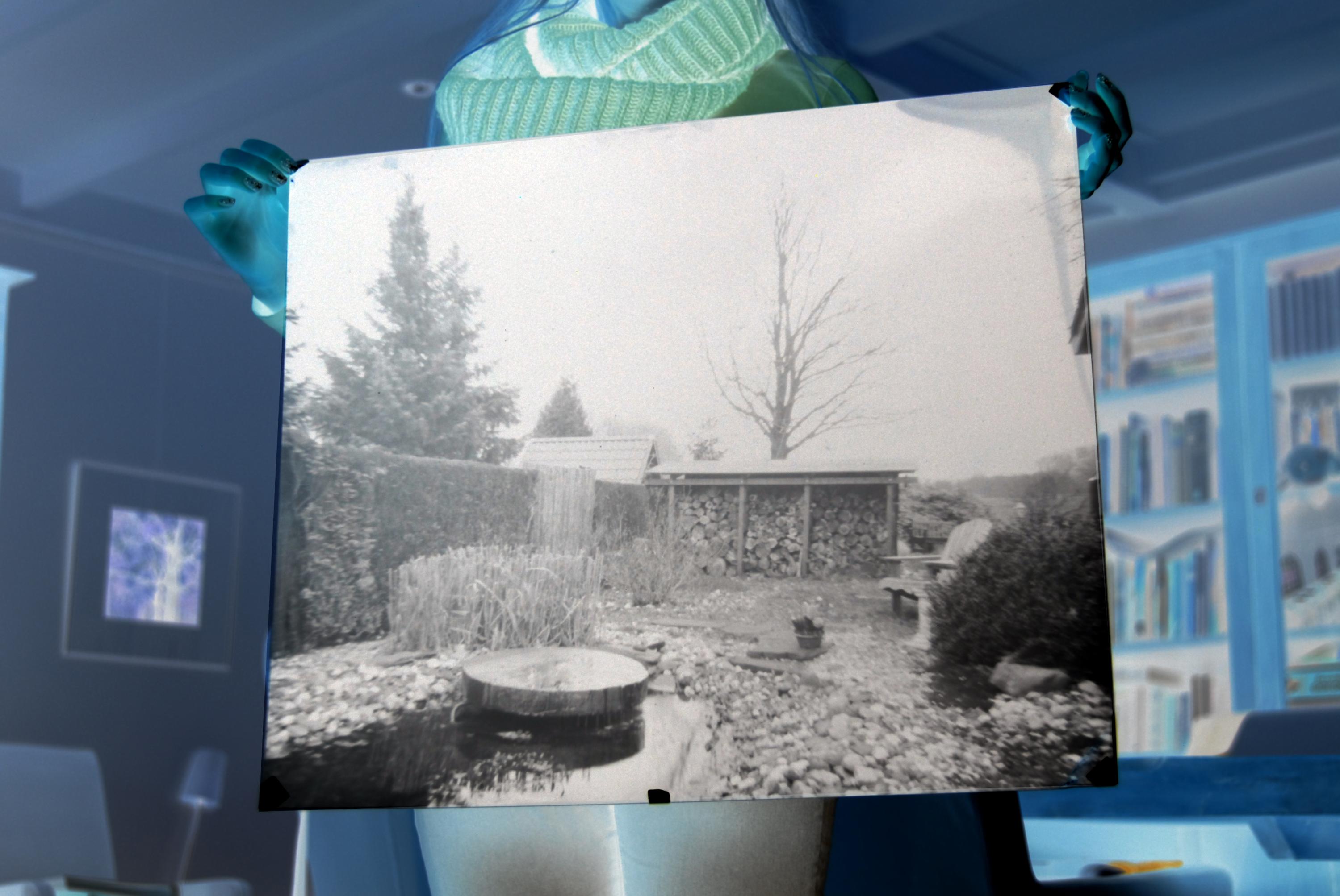

I made a 20x24 inch paper negative with a big pinhole camera made out of a cardboard box, similar to yours, for the previous MSA (cheap camera challenge) thread. To see how I did this, check:
http://www.apug.org/forums/viewpost.php?p=1608880
and
http://www.apug.org/forums/viewpost.php?p=1614832
and
http://www.apug.org/forums/viewpost.php?p=1617313
and the results:
http://www.apug.org/forums/viewpost.php?p=1617495
DSC_8706.jpg foto 4.JPG daughter-holding-20x24-pos_8754-2.jpg daughter-holding-20x24_8754.jpg
Above all: experiment and have fun! That's what pinhole photography is all about.
