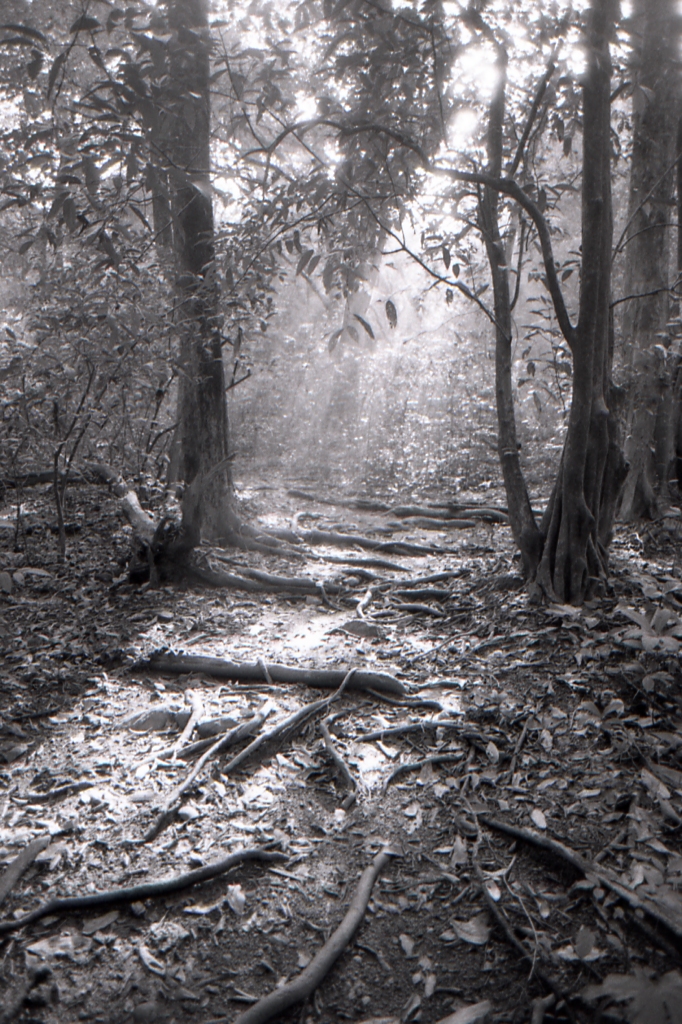

Worst case:
Ideal scenario:

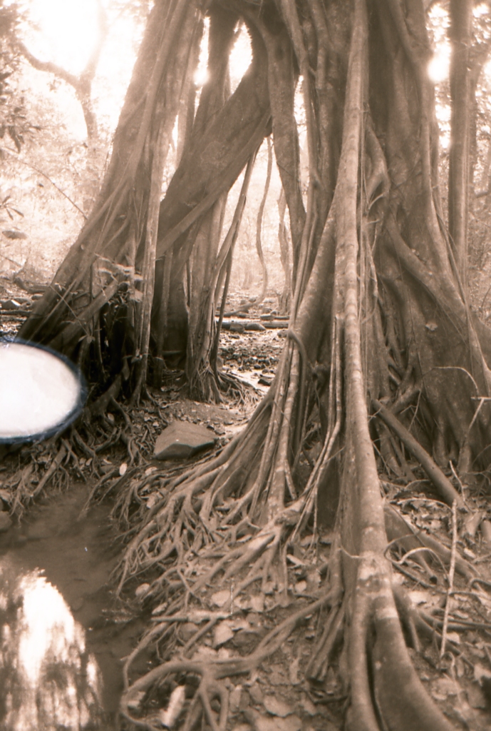

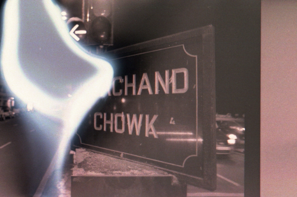

Slightly less than worse (look at the bright white spot on left)

Layers of film touching one another in the reel? (Or airbubbles...perhaps less likely?)

My guess too. Listen as you reel the film. You can hear the crinkling and feel a roughness when it happens. Sometimes you won't know it until you get near the end and it feels like you jumped a rail. 36 exposures should practically fill the reel. If you have two spirals left at the end, then you should suspect wrinkling.
It generally happens when you don't start right.
If in doubt, I prefer to unreel completely and try to make the film start better centered under the clip.

I concur. Definately film touching. Apart from that the Caffenol development seems to have gone rather well. So you needn't do much in the way of correction there.

I developed another roll of film last Sunday, with careful loading this time, and the number of 'lost' frames has drastically reduced.
From 6-8 earlier, now it's down to 3-4 and I'm counting smallish dots on the sprocket which would never print/scan.
Matt, Bill: I still couldn't use the clip (small changing bag maybe?) but a slow, even paced reeling seems to work better. The worst affected image was at the end of the roll which had firmly stuck to the layer below.
