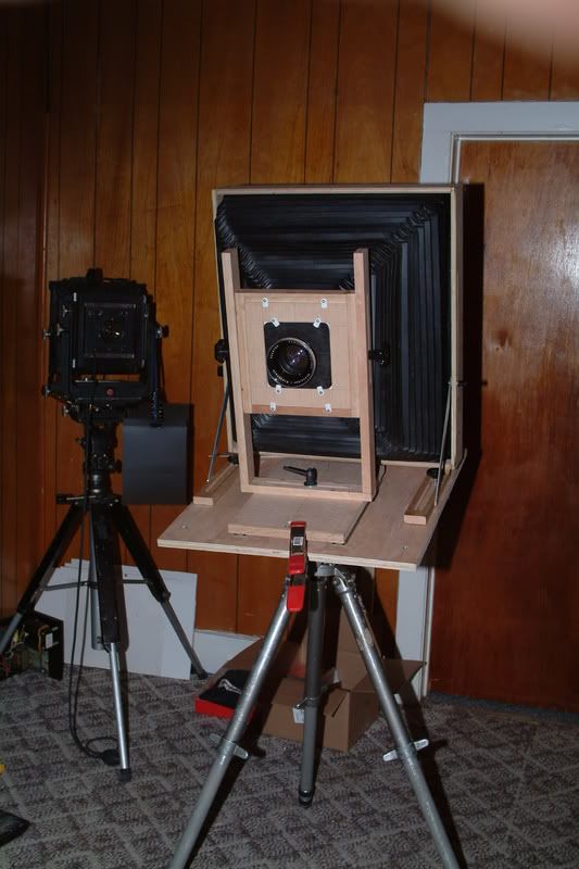

Kerry,
I guess it's one more to keep my eye out for then for this camera:
Right now, the 306 Componon covers 16x20, but my choices are pretty slim for 20x24 (which is why I haven't made a 20x24 back yet.)
erie
Pat,
That is a nice efficient design! congrats....I do nt see how the center extension board moves forward?

Kerry,
erie
Erie, very nice simple design. Gives me some ideas for the 11x14 I'm building. KISS is a good way to go. My next venture is to build my own bellows. Need to find the proper material and make a new one for my 5x7 and 8x10 cameras first and then I'll be ready for the 11x14. Do you use anything special. Thanks.
Jim
Jim, I had Grimes mount it. It looks as though there are machined aluminum adapters on both elements. If you like I can photograph them and send it to you.
