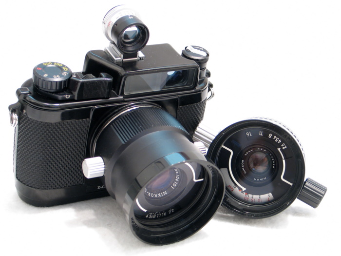

I have owned and used 3 of the 4 cameras listed. The FM2N is the only one I have never owned or used.
I cannot comment on the weather sealing of the three cameras because I never used them under rainy conditions. I used a backup camera instead. The first backup camera I tried in the rain was a Nikon EM.
When the rain caused the EM to short circuit, I replaced it with the waterproof Nikonos. The 35mm wide-angle and 80mm telephoto lenses I mount on the body can be used under or above water.
https://flic.kr/p/8WWa9S
