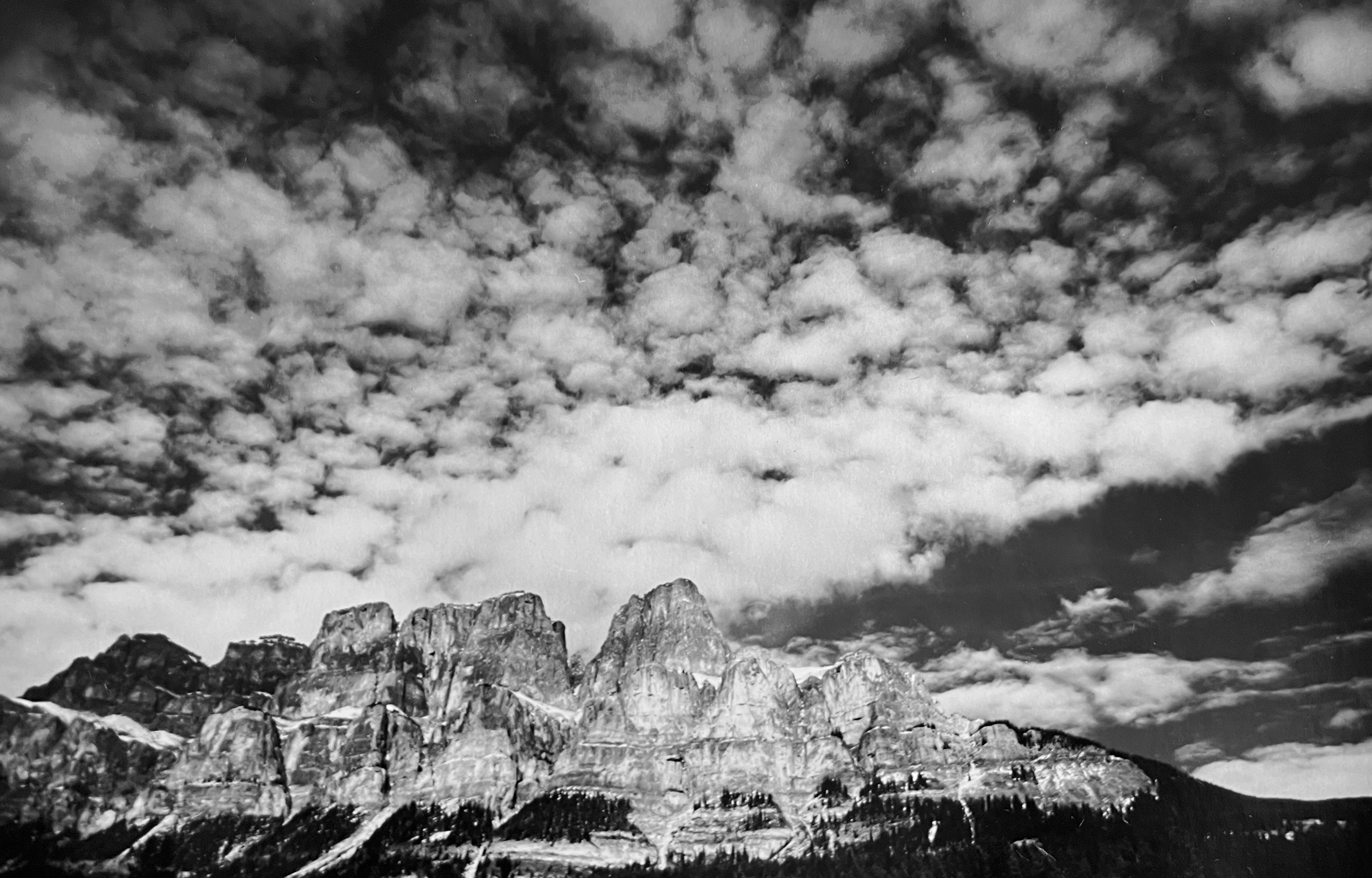

i can't say with pota, i've only developed CMS20 @6.....in Adox FX39 IMG_7675 copy.JPG
i can't say with pota, i've only developed CMS20 @6.....in Adox FX39View attachment 403305

I've been using FX-39II more and more and liking more and more with certain films. I haven't shot CMS20 for a while, but if I do I'd like to try it in FX-39II. Did you use a highly dilute mix to compensate for the higher contrast in your shot above? Any filters involve with the shot above?

John i used a yellow filter and mixed the Adotech according to instructions.
