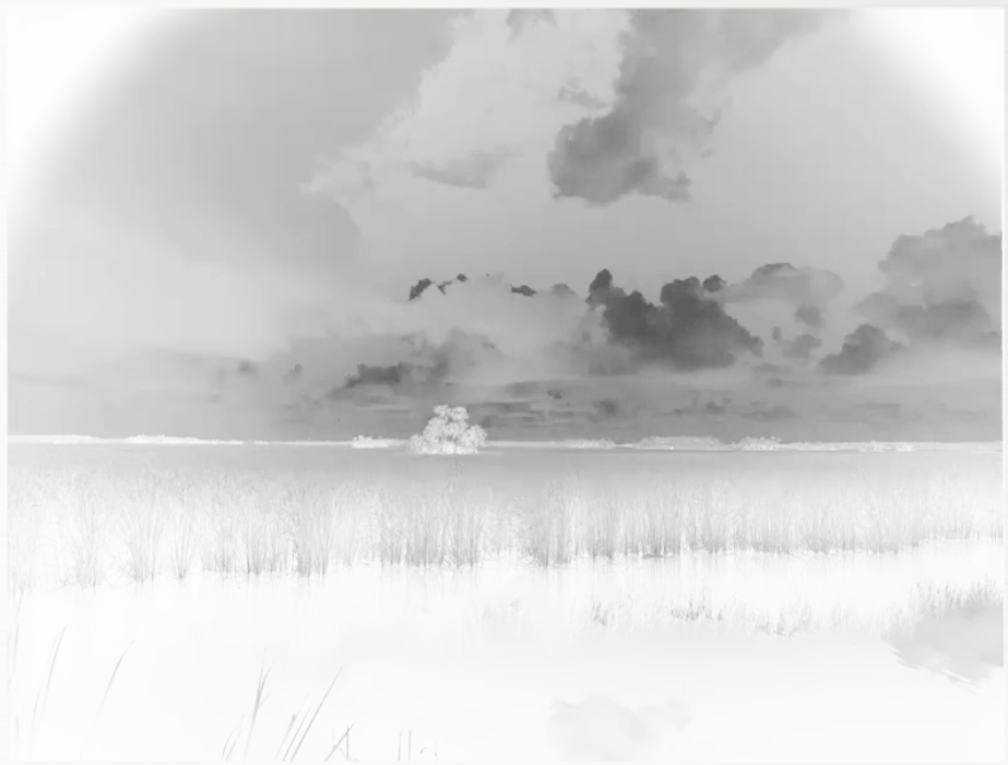

I also reversed the raw print to check out what he would be seeing in the negative.
Like myself and others, most of Butcher's image editing is done from the negatives on a light table. "Negative Parties" as Clyde called them.

Cropped off most of the weeds in lower left, cropped the right edge a little, cropped the top enough to remove most of the vignetting and covered the rest with burning, split printed the sky at least one grade harder contrast than the foreground, which is at least one grade harder contrast (and a stop darker) than the straight print.
The mechanics are fairly straightforward; the talent lies in, first, seeing the final print in that negative, and second, in getting to it.
