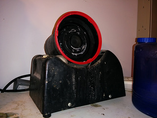

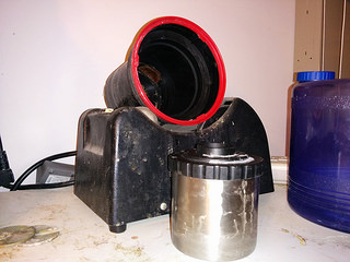

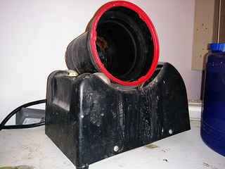

I rotatory process my film in stainless steel tanks with stainless steel reels. I have a besler motor base with a Patterson universal sitting on it. The stainless steel fits inside and is held at an angle. I use 175 ml of developer, but usually only process 1 roll at a time. Works great!
It doesn't have to get complicated. It may look ugly, but this is what I have used for the last 5 or so years......
If you cannot see clearly, the last photo shows the ss can easily fitting into the paterson with the ss take lid holding it at the outside edge. The angle is set to be able to use 175 ml of fluid wth without the cap on the ss tank.
