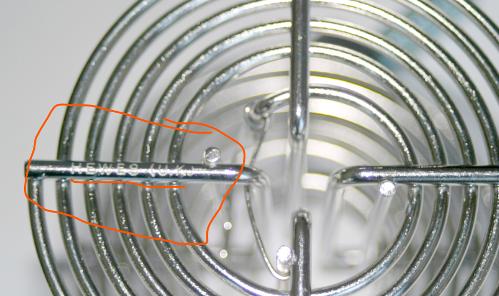

If you come across used reels and are wondering what brand they are, the HEWES reels that I had had HEWES inscribed on the cross braces, like this:

Matt -- I vaguely remembering Hewes went to a a lighter gauge that is no longer printed with "HEWES". But I won't take a bet on it...
But 120 reels by nature are stiffer beasts than the thinner-gauged 35mm reels. I use a variety and as long as they are not bent, all seem to work fine. Just center oneself to the universe...

The Hewes 120 and 220 reels have wire clips just like Brand X, I don't love that "feature" but the build quality is still first rate. BTW the clips feel "backwards" compared to some others so you don't want to try using a mix of 120 reel types, it will mess with your head in the loading bag or darkroom!
