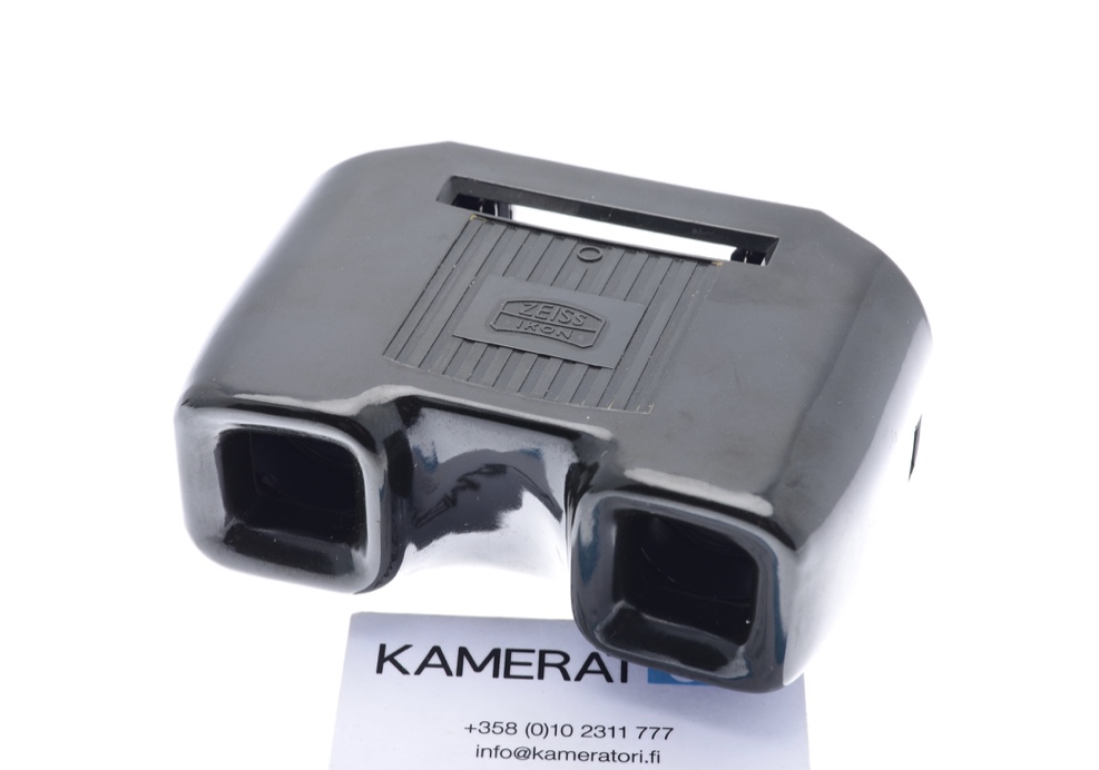

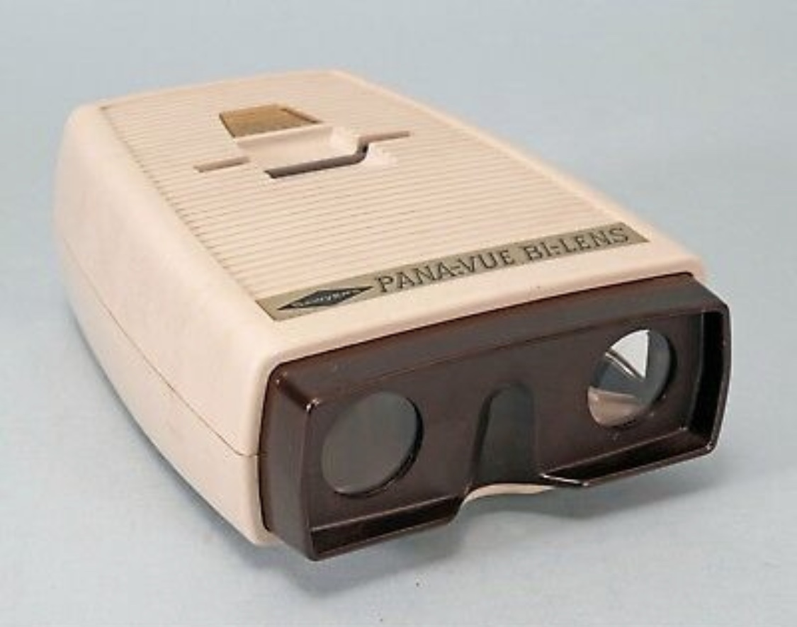

Well, just two examples:
I have a crappy Minette viewer, whose only redeeming feature is that it collapses into pocket size.
