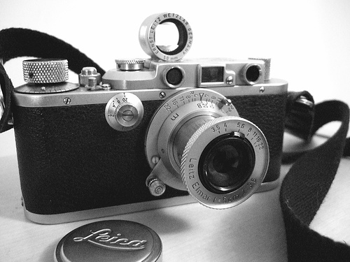

If your goal is to shoot with both eyes open,
so that the framelines seem to float in the
field before you, there is another approach
that satisfies your requirements, better than
any other yet mentioned: Get an LTM Leica
-- a IIIa for example -- and a viewfinder to
fit in the accessory shoe for the FL you desire.
The Leitz viewfinders are brilliant and not too
expensive (the SBOOI is the 5cm finder, but
they are available in many FLs), and Voigtlander
makes very good finders for very little money.
The Leica screwmounts are jewels of cameras,
inexpensive, small, all mechanical, no batteries
-- joys to use and own. And with the viewfinder
perched on top, it is easy to shoot with both
eyes open, with floating framelines.
The downsides: You have to focus through the
rangefinder window (or zone focus), and you
have to correct for parallax up close. The Leitz
finder has a second frameline to account for
parallax so it's not a big deal, but you have to
remember it when shooting close.
