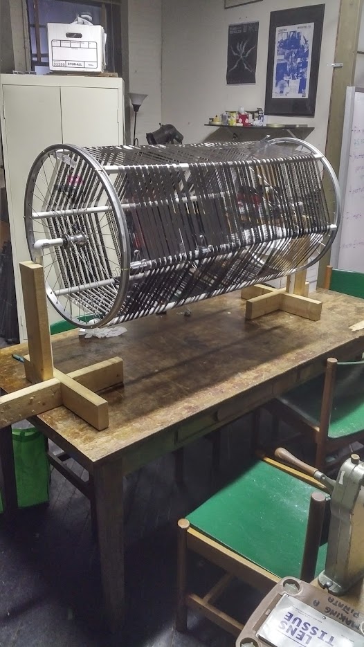

Thank you all for the collective wisdom! Photo for fun of my drying rack after the last time I processed a couple hundred feet of 3378E.

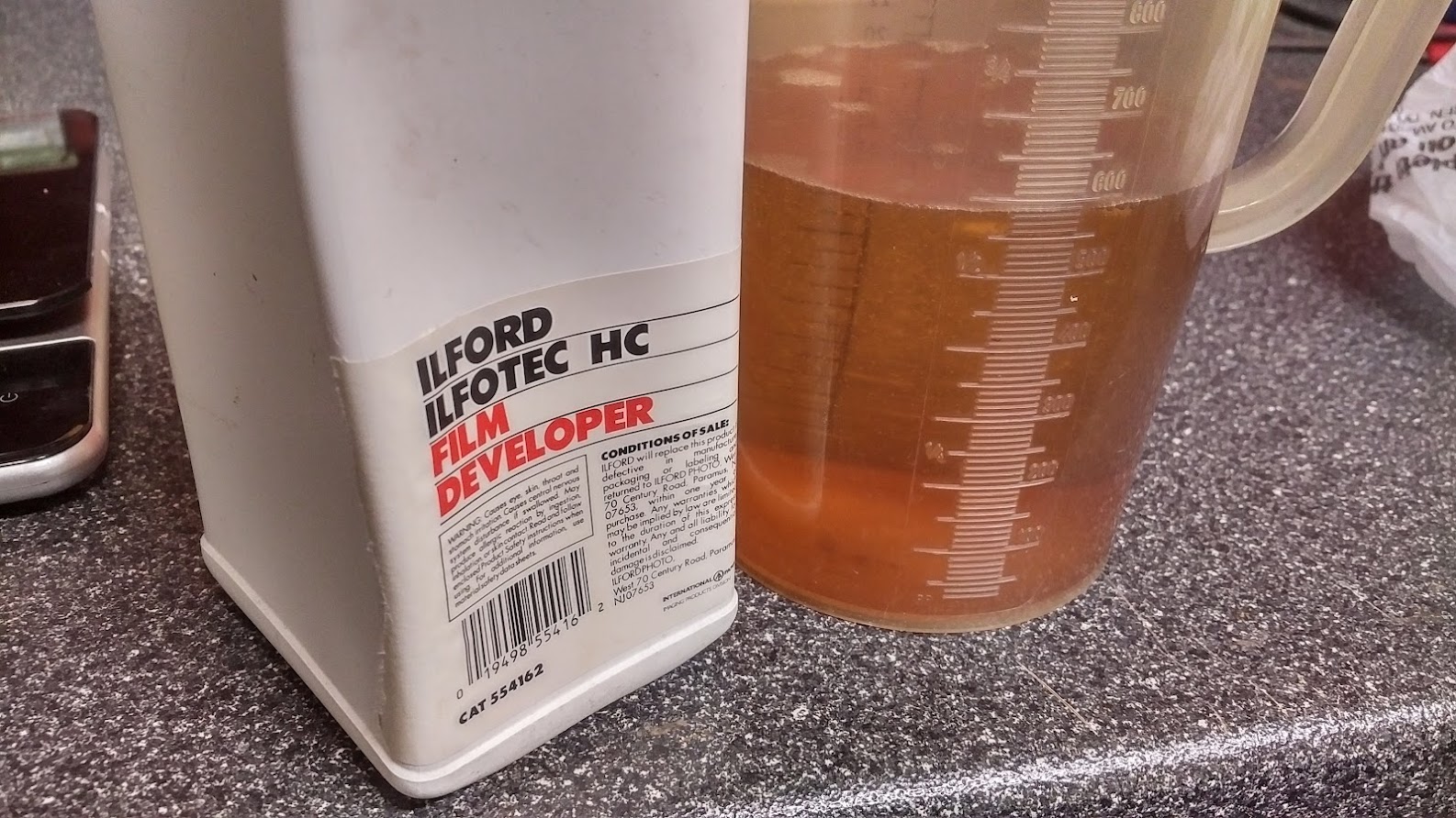

Well, I'm glad I did a clip test first: "it's dead, Jim." I had two unopened bottles of Ilfotec HC, one so old (pictured) it had no website on it; the other was modern enough to have Ilford.com but both were dead. The older (darker yellow) after 5min at very strong concentration could produce medium gray, but the newer bottle was stone dead. I'll have to get some fresh HC-110 / equivalent and try another day.
Can anyone speculate a redeeming experimental purpose to keep the dead concentrate around, perhaps for the diethanolamine / diethylene glycol, if I'm preparing to mix some more developer anyway?
During WWII a BJP (& Almanac) article suggested re-using film developer for prints, essentially increasing the pH and adding extra developing agents. Here in the UK materials & chemistry were in short supply to the public, so it made sense.
Ian
That bottle is probably labelled as being from the "Ilford Imaging" (pre-2005) version of Ilford, but it could be from even earlier than that. If you keep it much longer, it might soon qualify as a collectable antique!
