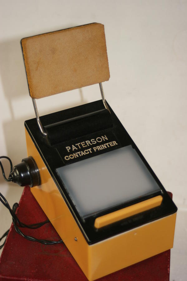

Francesco - Whilst browsing the stock of my local drug dealer (second hand camera shop), I came across a small gadget that would help you on your way. The glass measures a nominal 6x9, but would be better suited to using with 6x7 or smaller negatives. If you're interested, I'll weigh it and work out how much it would cost to ship to Rome.

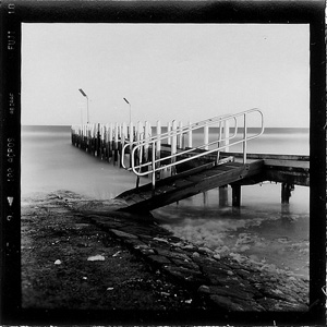

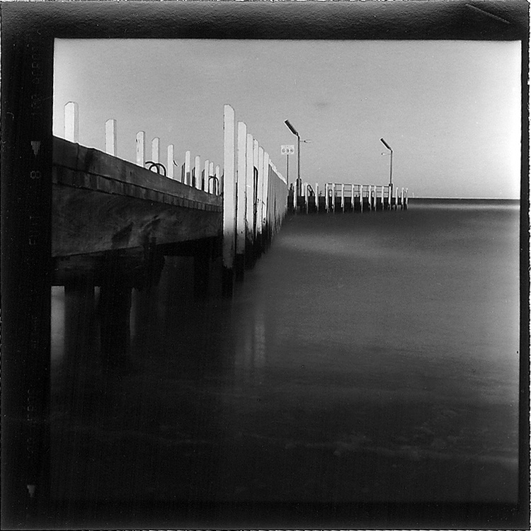

I have one of these and have used it with little 2.5"x2.5" and 2.5"x3.5" Kodak Velox Contact Paper. The paper is mostly from the 60s (I believe), single weight and makes rather cute prints. Since it's a contact/gaslight paper, it's very slow and I've used it in my little contact printer whilst sitting on the loungeroom floor of an evening around dusk. In other words, it doesn't need to be pitch black or under dim red safelight. Print times were between six and ten seconds depending on the density of the negative. I've also used it beneath a piece of glass beneath a bare 75 Watt light bulb sitting around two and a half feet away.
The paper turns up on ebay on a fairly regular basis. If Paul sends you that Paterson printer, I'll happily send you a little packet of paper (2.5"x3.5"). It's only a pack of twenty five - (minus one or two so I can check it for fogging - see 6x9 print for example), but it will give you something to play with :smile:
