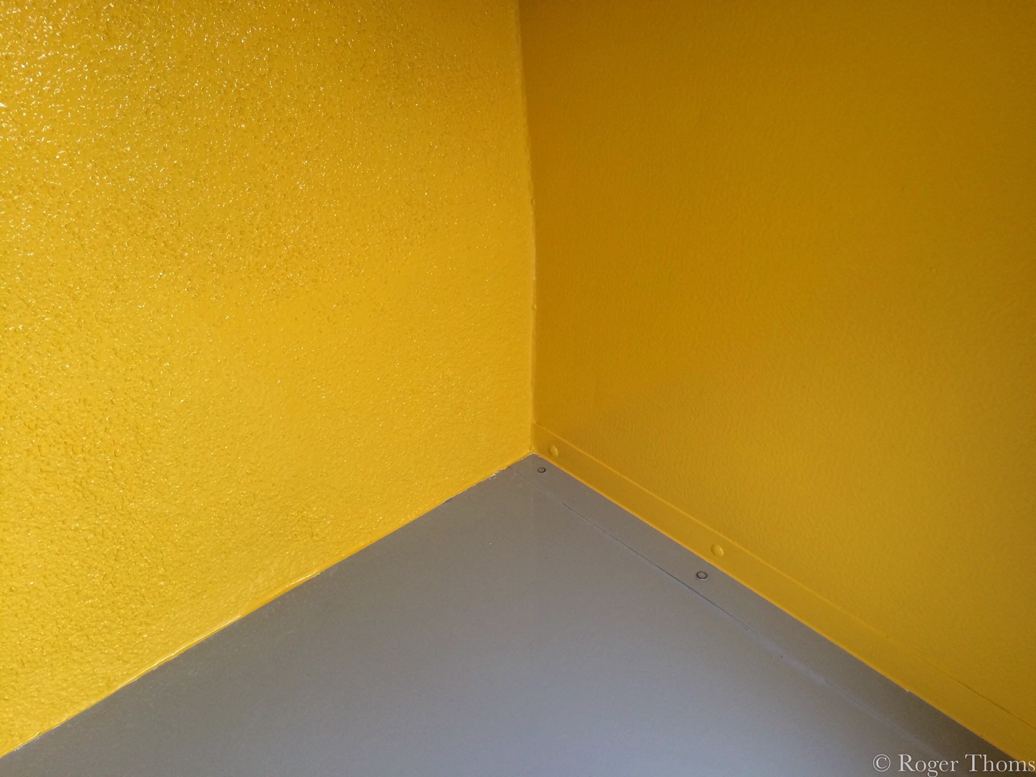

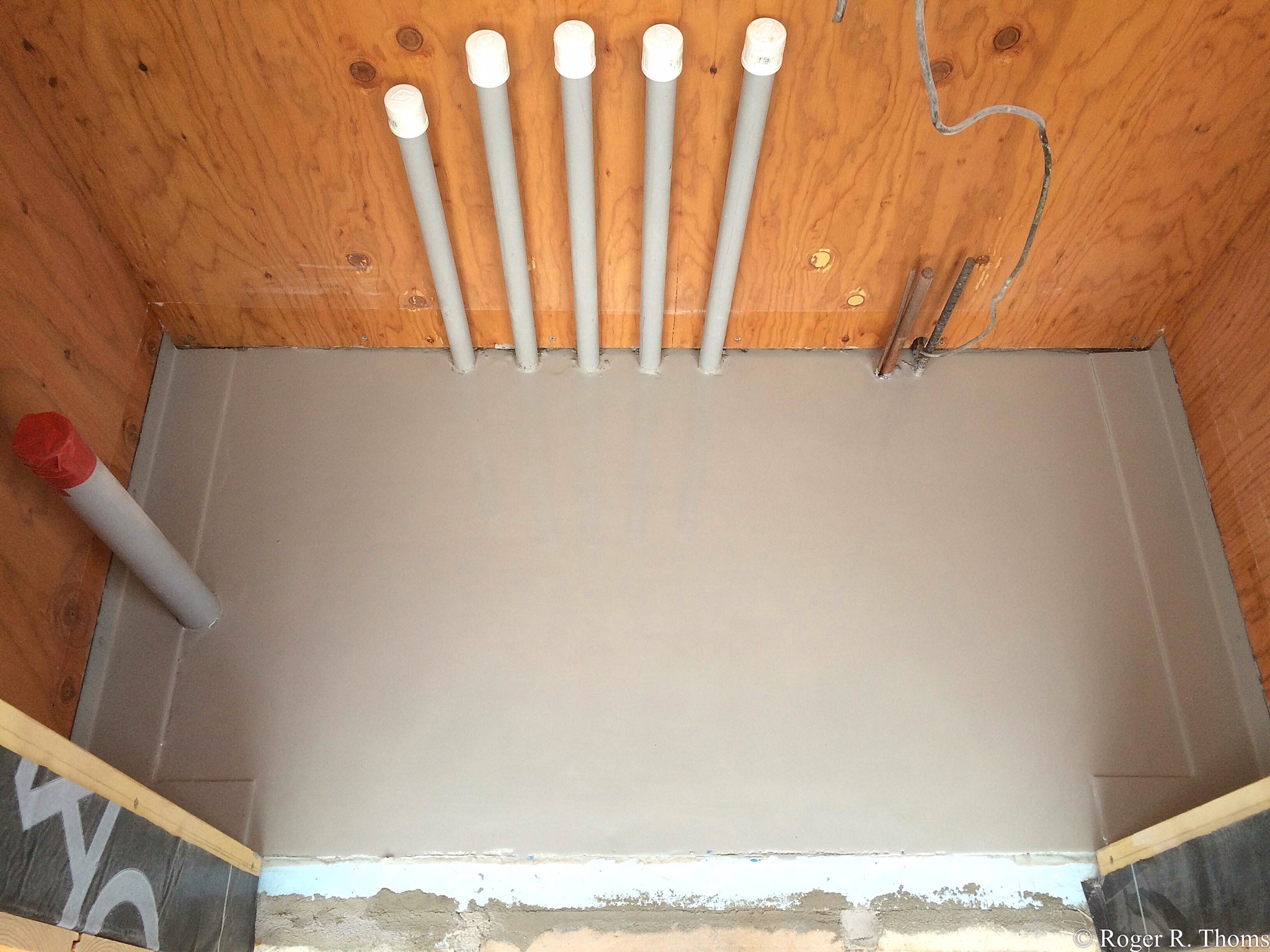

You could use West System epoxy with their grey pigment https://www.westsystem.com/503-gray-pigment/ . West System epoxy is popular for coating wooden dark room sinks and although I haven’t used it for that, I did the floor of my power shed and battery compartment and it turned out great.
Roger
