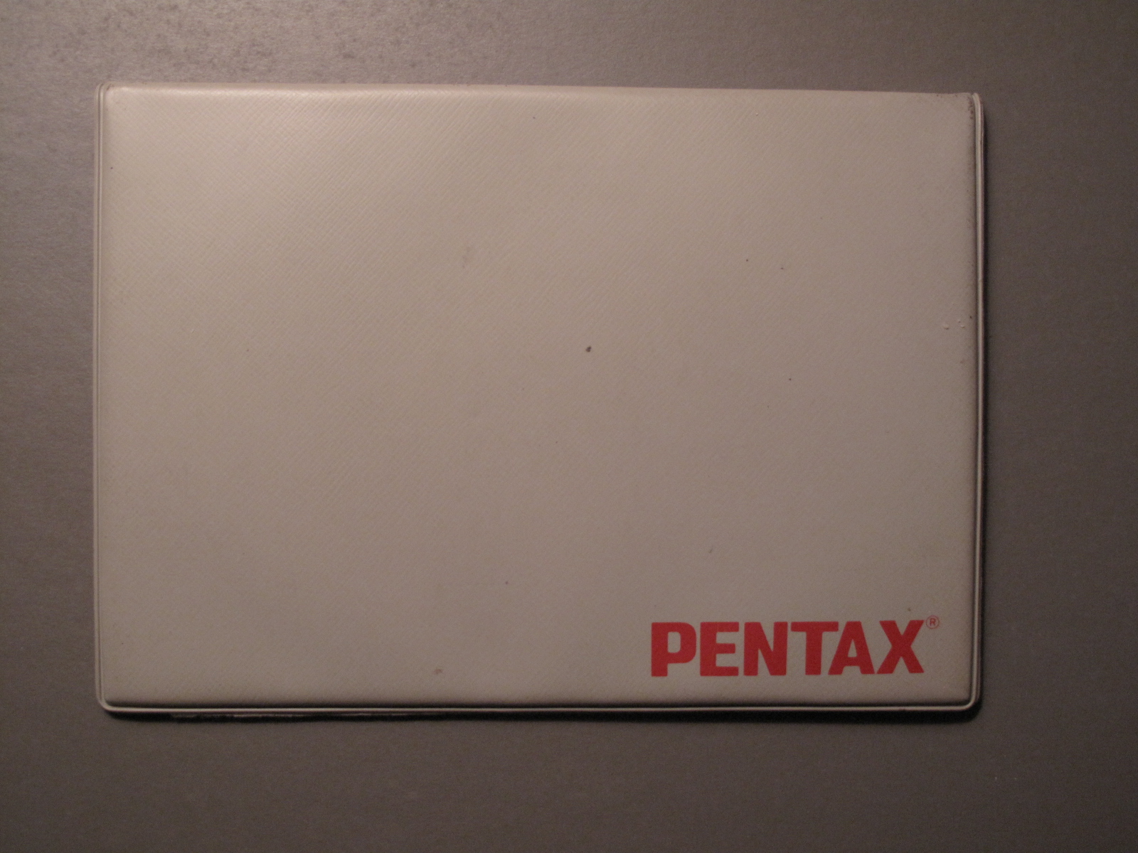

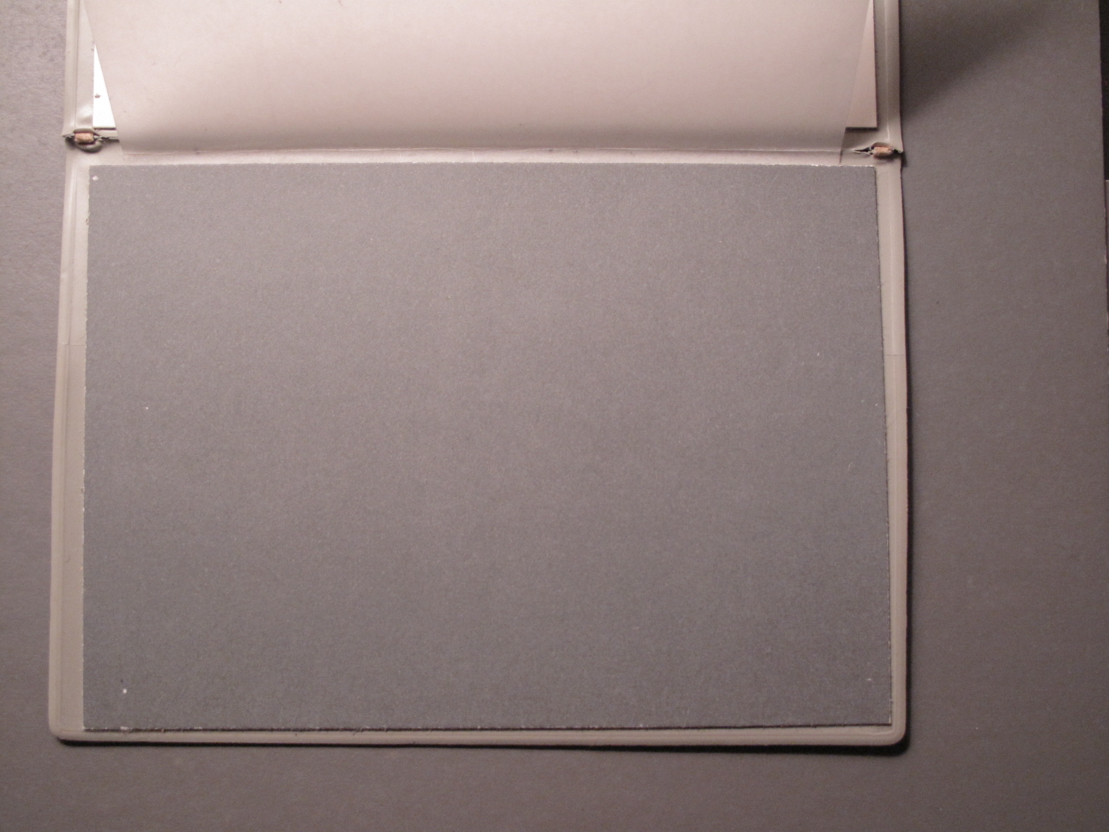

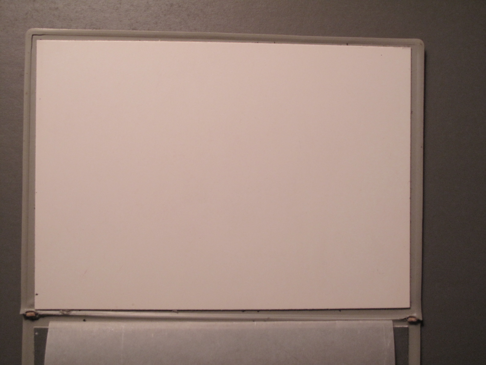

I have had my Kodak gray card for about 25 years, I sprayed it with Krylon Matte Finish which makes it not totally waterproof but pretty darned weatherproof. It measures 4.5 by 6.5 and it's in a plastic folder which I'm not sure where I got but it works great.

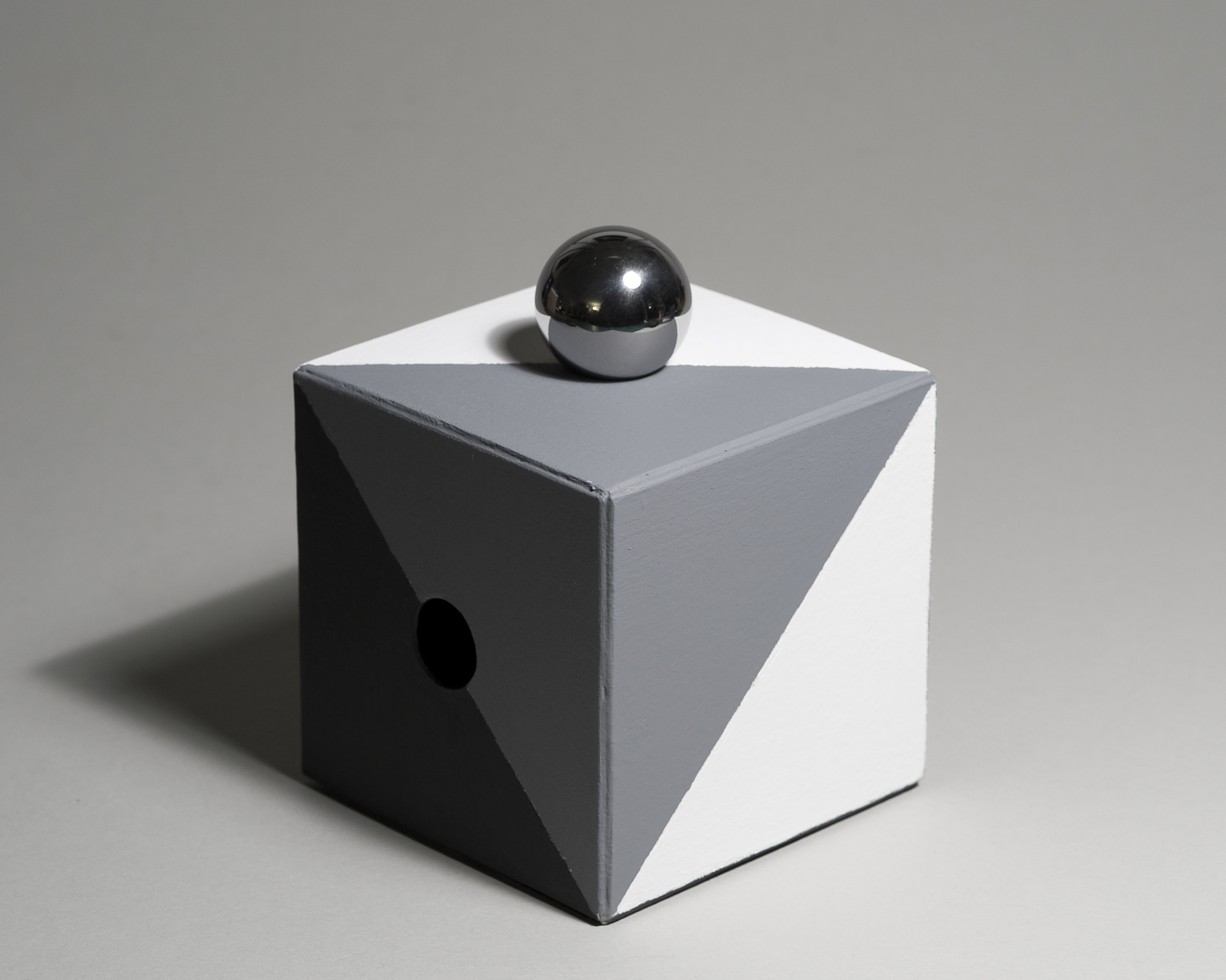

it is not too hard to make your self any gray card%as long as you have a densitometer,some mount boardand weatherproof paint in neutral white and black.t's what i used for my zone cube:
