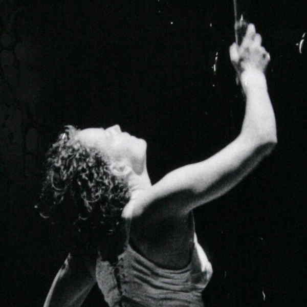

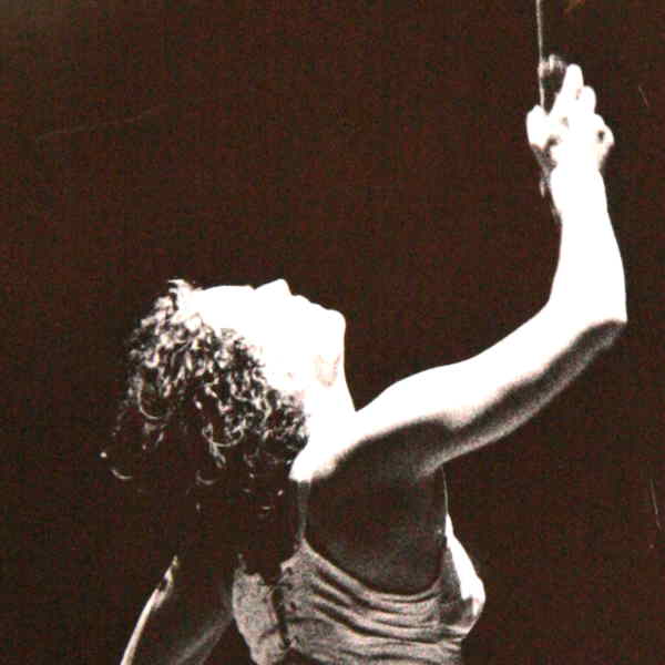

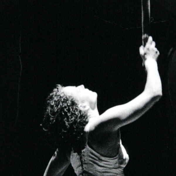

This is fairly easy to test. Take a few prints, and selenium tone for a variety of times, then bleach with a standard Ferri/Br bleach.
Here are a couple of examples I have just tried. These are using two test prints from a previous session, photographed with one of those computerised imagey things with a lens on the front.
I tend to use a moderately strong toner, and in this case it was selenium stock (Fotospeed), diluted 1+9. Bleach was 2.5% ferri (10% stock, diluted 1+3), with approx 8g of potassium bromide added to 800ml of working solution. The prints were made on Ilford MGIV RC, developed in Beer's #5.
The first image is the untoned print; the second is the straight toned print (in this case 3 minutes in the toner described); the third was toned for one minute, then bleached for ten minutes; and the fourth was toned for three minutes, and bleached for ten minutes.
As you can see, the one minute toned print has lost pretty much all of the highlight detail, and a lot of the shadow silver has been removed as well. With selenium toning for three minutes, the shadows and the midtones are holding up much better, but the highlights have still gone. I think given five to six minutes in this concentration of selenium toner, even the highlights would be immune to the bleaching.
So, whatever the mechanism underlying the action of selenium toner, the highlights definitely appear to tone last.
(Apologies for some of the wierd reflections on some of the shots! :sad: )

Maybe so. Tim would be the guy to ask, he could probably point you at the appropriate literature about selenium and archival toning.
Though if the finest particles were first to react with the selenium to form the selenide, then I think the highlights would remain when attacked with the ferri bleach. I don't think ferri is sufficiently agressive to attack the selenide. Peroxides, or dichromate bleaches, yes, but not the ferri.
In the discussion in his book on toning, Tim mentions that studies show that the larger grains of silver in the shadows are not converted to the selenide, and that shadow toning starts with the smaller grains of silver. That would suggest that the highlights should be toned first. The fact that it is reported that they are toned more slowly than the shadows, and midtones, suggests that the actual mechanism of selenium toning is far more complex than a straight forward fluid phase chemical reaction.
