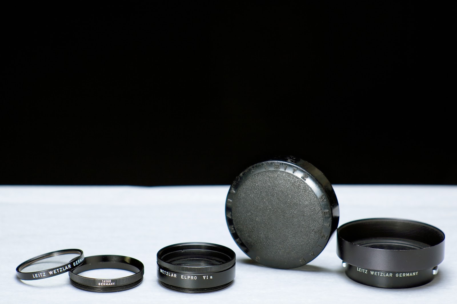

Thanks. I'll know I'll have to play around a bit, but trying get the basics down ahead of time. The print sizes are all over the place. I'll be re-photographing many roughly 9x13" prints to do extreme things with the contrast, but I also will be doing much closer shots of contact sheets, Polaroids, details of larger prints, etc. Sometimes I'll want a nice sharp reproduction, and sometimes intentional degradation. In terms of focus, the larger prints can be handled by the unaided Summicron. I ordered the ELPRO filters online yesterday, as they were pretty cheap. I won't be exceeding 1:1.
