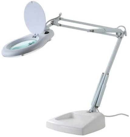

Am looking at those LED with magnifier but I don't think the magnifier is the way to go.
Works well for me; I use one with a magnifier and a ring of white LEDs surrounding the magnifier. Most of the time I don't use the magnifier, but the accentuated arm & head and bright light source are useful even then. This is the type I use:
With one minor difference: mine clamps to the desk, which is actually more convenient.

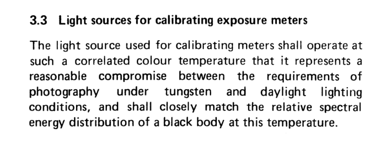

Best light source for camera repairs?
A calibrated light source :smile:
I have one of these types too, and I don't use the built-in magnifying glass either, as it's too bulky.
Two of them would be helpful to be able to illuminate without shadows, but I don't have the space for that.
The LED light can be adjusted in color temperature and brightness.
