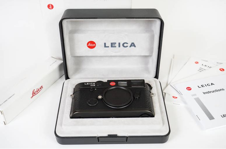

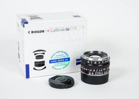

Thank you all for the inputs! As I was shopping for the lens, I ran into someone who was also selling an M6 TTL (.72X) that he was using with the lens. I had actually initially corresponded with him in regards to his satisfaction with the combination and in our interchange, I ended buying both the body and lens (which sound and appear in nice condition) for a very fair combination price. If I acted too quickly, I can always move the M6 as it seems there's a pretty steady market for these.... It's in shipment as I write this. I'll report on my experience in case this thread is searched by someone in the future. Again...Thanks!
