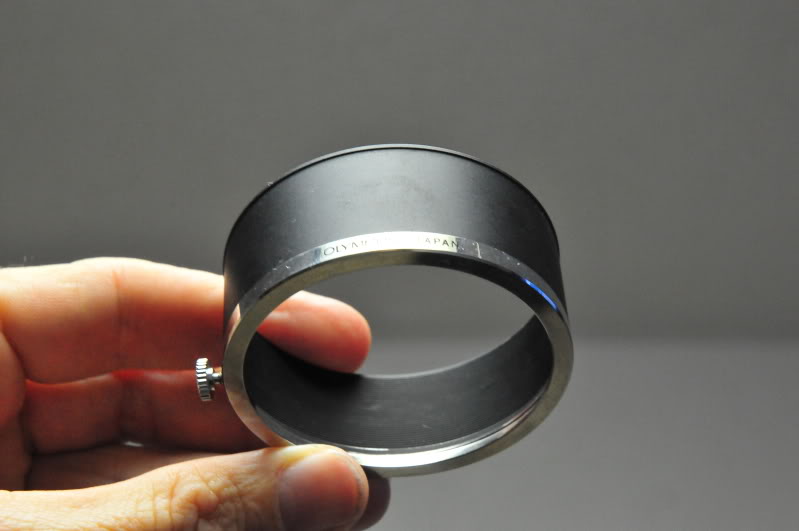

Here's an original hood which I used on my RD. The same hood also works on the DC,

Good, that looks about the same size as the 49mm screw-in hoods I am looking at.
So I probably wont have any issues with them.

Dallas, TX
