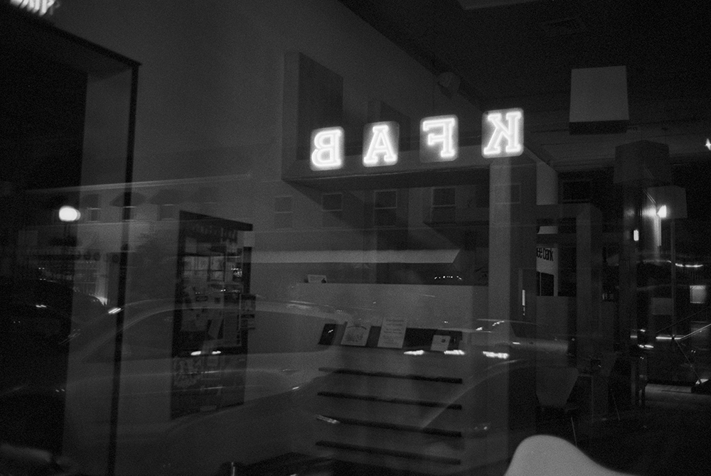

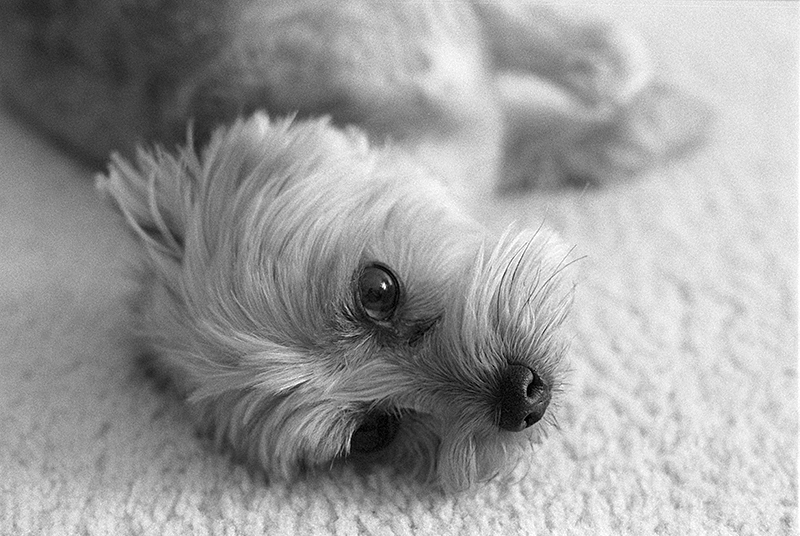

Here are a few examples of Delta 400 in DD-X pushed to 1600. There's some grain, but you really get a nice range of tones.

Nathan, I love the tonal range of the dog, very smooth, and am very suprised by what was available in the very low light setting of the second one. Is that a restaurant? The grain is not as exaggerated as as I would have expected in DDX. Is this a scan of a negative or print? One other thing, is that 35mm, or medium format?

They are both 35mm negative scans. The prints look essentially the same. The grain doesn't become too much until you enlarge past 8x12, if you don't mind some visible grain. The second shot was taken in the dead of night with only weak street lighting. F/2 and 1/30th of a second, I believe. KFAB is our local radio station. DDX does a really good job at keeping the contrast and grain in check. I agitate very gently two inversions per minute.
