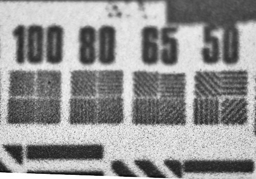

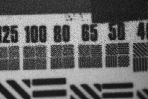

From the parts of the attached photomicrographs of chart negatives that are in focus, it is possible to see that solvent developer Xtol 1+0 gives finer grain but acutance developer FX-1 (rather similar to Neofin Blue) gives an apparently higher edge sharpness.The film is the Adox/Efke 25.
Left-Xtol,Right-FX-1.
