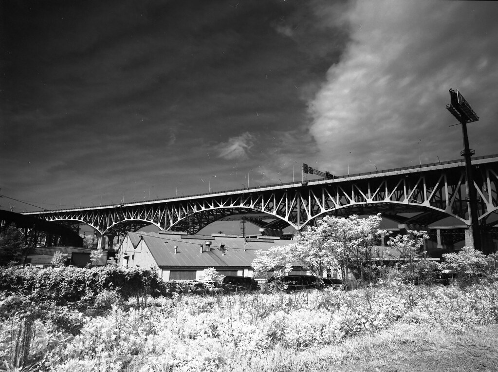

I've had good results with Rodinal (Blazinal) with IR400 exposed at ASA-25 and developed in 1+50 for 12:00 (Also with an R72 filter)
I'm going to try some different developers this spring/summer.
Those results look great.
