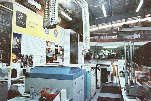

Here is a description of pre-flashing, no matter which film you go with, you'll get better results using this technique when dialed in to the right amount.
This technique will significantly increased recorded detail, improve contrast and grain. So I would use it if you didn't want 'clumpy grain', and retain as much tonal range as possible. And I would use it with T-Max 400 in accordance for those wishes for good grain.
http://strobist.blogspot.com.au/2013/02/how-we-got-here-analog-photoshop.html
I haven't used it on B&W, but I did use it on C-41 once.
No-preflash and push (Superia 800 to 12800)
Superia 800 @ 12800 no preflash by athiril, on Flickr
Pre-flash (finally at the right amount) and push (Superia 800 to 12800)
Superia 800 @ 12800 Zone 3 preflash by athiril, on Flickr
