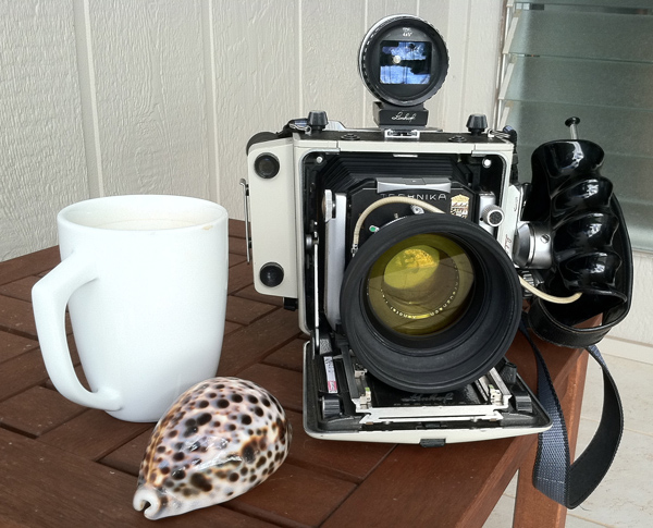

All the cameras you mention, and just about any camera that shoots 6x7 is a professional camera that is capable of making excellent images. Because 6x7 requires a mechanical frame counter and can't rely on the red window, I don't think it's ever been an amateur format.
This is what I use for 6x7 these days, but it can also shoot 6x6 and 6x9 rollfilm formats and 2x3" and 6.5x9cm sheet film with the right backs or sheet film holders. In practice I use either 6x7 or 2x3" sheet film. It gives me most of the view camera movements of my 4x5" Tech V, but the whole kit takes up half the space, and I can also use the rangefinder to shoot handheld press-camera style.

I was considering a 2x3 century graphic with a 6x7 back a grip like yours and a wider lens but the lenses seem very expensive

The lenses are as cheap or as expensive as you can afford, really. There are many fine older lenses that are very reasonably priced, like f:8 Super-Angulons, and normal to longer lenses like Symmars from the 1970s and 80s. The latest designs are more expensive and sharper with better contrast, but the main thing they offer is more coverage, and you can't necessarily use all that coverage on a press camera, which has more limited movements than, say, a dedicated wide-angle camera or a monorail, so you wouldn't necessarily need to spend that much on a wide lens, unless you were also planning to use it on a larger format or on a camera with more extensive movements.
