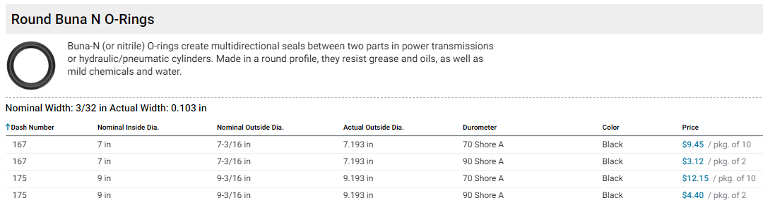

Just replaced the belts on my 120 carrier and the 35mm. The O rings from Grainger DASH 167 (35mm) and DASH 175 (120) fit and work perfect.

Note: These are for a Beseler 45 enlarger. I used rough measure of diameter then c/pi to get diameter. Thickness of ring in mm was measured by laying it on ruler. Nothing precise, but close enough.

My 35mm does not have any model numbers. Grainger.com, DASH is the way O rings are listed in the U.S.A. I think it is part of an aerospace specification to find part in a table. Not sure if adopted globally.
Brilliant; these seem to be them:
This should help people elsewhere in the world select a suitable alternative.

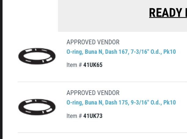

Do you have the ring's width and durometer? Or Grainger's part number, I found 41UK65?
I chose 70 shore A based on how the original felt in my hand. Plus its one of the most common hardness levels in similar uses such as audio/video transport mechanism.
