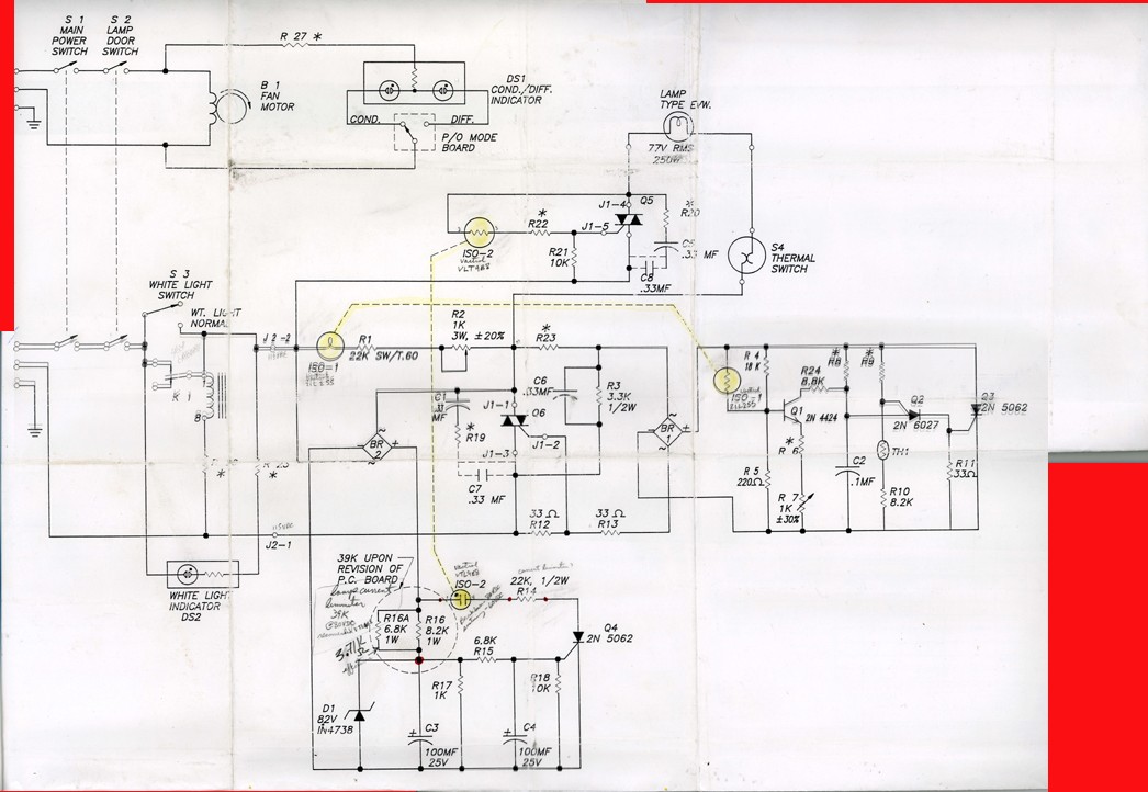

For those having trouble with the Besseler Duel Dichro electronics... lamp delays n flickering.... Its the vactrol that goes on these. Ive been asked many times to post the scematic n here it is again.
