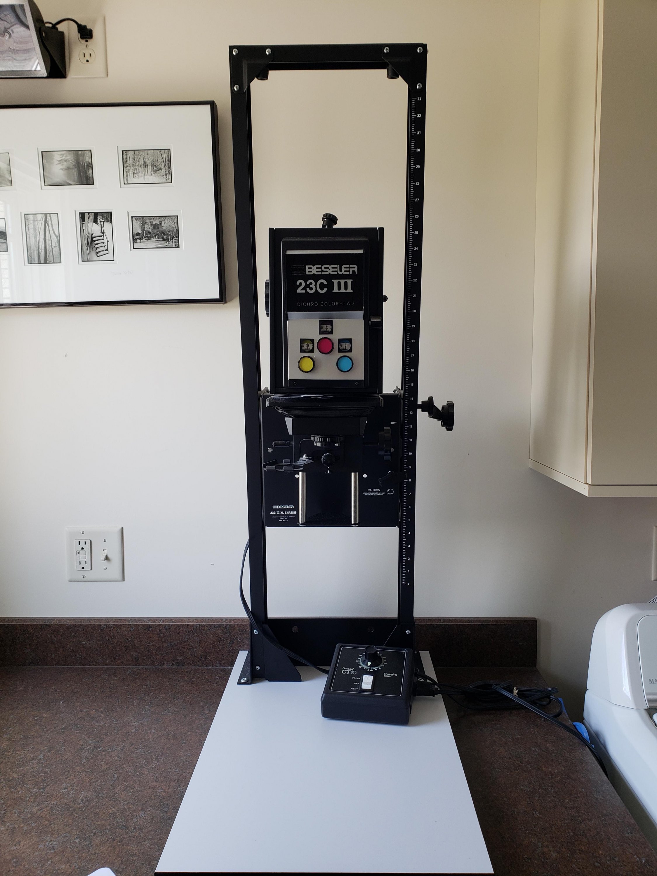

I already have NOS Beseler 23C II that I use for B&W. Paid $20 (twenty) for it because it was missing a few small parts. Got the parts on sleazebay for <$20 so still a good deal :smile: . . .
Anyway, I have a lead on a very nice 23C III XL with Dichro Colorhead . . . No idea on pricing yet. I will be visiting it sometime in the next few days or so . . . What should I look for before deciding on a purchase? Also what would be a good deal? 23 C IIs are listed on a 100 mile Craigslist search from "free come and take it out of my garage", a PAIR for $20 . . . on up to $299.
I have never done color before. But if this is a good deal I may give it a try.
Thanks in advance . . .

That's a pretty enlarger . I used a Dichro head for years for VC. I have accumulated some amazing equipment that people just want gone. It's hard for people to understand that something that they paid several thousand dollars for 15 years ago is going for 5 cents on the dollar.
I have 4x5 Beseler equipment, works great.
Color printing is a lot of fun, remember that Fuji is the last company to make cut sheets of color paper. Everything Kodak comes in expensive rolls.

If you get the dichro, you'll likely find yourself eventually using it for B&W VC work. Much like a cold light for spotting issue advantages over the condensor. I know of these popping bulbs. It tends to be caused by corrosion on the bulb sockets and pins. If it's been sitting for awhile, you might want to clean them up with some abrasive.

Make sure the mixing box is suitable for the largest format you shoot.

The newer Beseler 23CIII have baseboards that are prone to warping. My 23CIII with the color head needs a new baseboard. I'll be making one that is thick & WIDE or I will have a wall mount fabricated. I'm leaning toward the wall mount. Good news is I have so much B&W work to do I won't need the color head until at least June.
