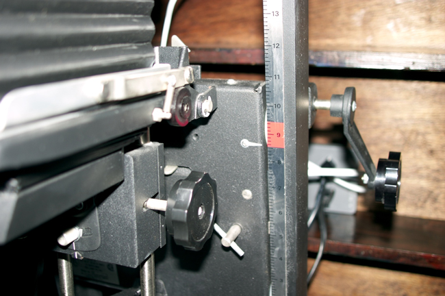

I can't get the whole top assembly to move lower than the 9 mark on the rails (which is marked in red), is there some sort of lock?

The lock is the t-shaped bolt aligned with #5 in your picture. If you can move the carriage upward, the lock is not engaged. Any chance a cord may be hanging up from the top? Check the rail channel as well. I've had to place a wooden stop in the rail of a motorized 45M to keep students from smashing the carriage into the baseboard. Perhaps someone did something similar to yours. No teeth missing on the gear rack is there?
Problem solved: There were a few pieces of tape on the inside of the rails preventing movement, thanks.
